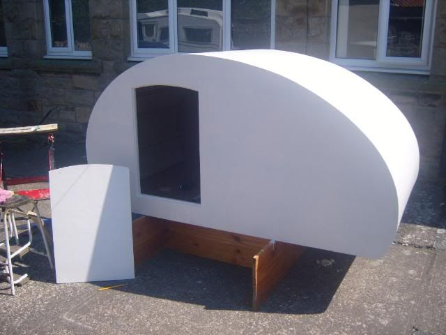

Postby sqweaka » Fri May 29, 2009 3:29 pm
my son wants me to do it matt or satin black to match the 'T' but i'm leaning towards a cream/lemon shade of paint, maybe a two tone, might give it a 50's look! not made my mind up yet. next big step is the door (only one)
what shape n how to cut it out cleanly.

Postby sqweaka » Sun May 31, 2009 4:14 pm
day 5
cut the door, framed it and give the thing a couple of coats of paint!

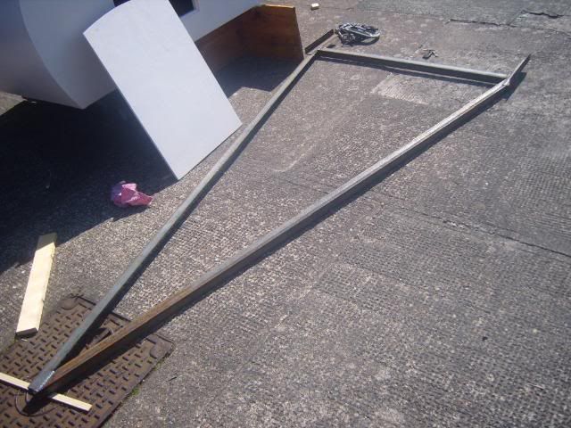

next knocked up a basic chassis with some 2x2 angle
gave the chassis and suspension units acouple of coats black paint!

Your frame has made me curious. I've got to dig up the chart that shows the horizontal and vertical weight limits for different configurations and materials. For my own enlightenment, I would like to know the limitations.

Postby kennyrayandersen » Mon Jun 01, 2009 6:18 am
tinksdad wrote:
Miriam C. wrote: But you shouldn't go knockin up chassis'. You'll have a bunch of baby chassis runnin all over town and country.
:rofl: :rofl: :rofl: :rofl:
Definitely gonna be a lite-weight build. Looking good so far.
check the design library, Andrew has put a really good tool in there for doing those calculations and also included is a table with quite a few sections (if you need others I'm sure I or he could help with that calculation)

Postby sqweaka » Mon Jun 01, 2009 10:32 am
not sure what your on about, can you run that by me again :?

Postby tinksdad » Mon Jun 01, 2009 5:12 pm
kennyrayandersen wrote:check the design library, Andrew has put a really good tool in there for doing those calculations and also included is a table with quite a few sections (if you need others I'm sure I or he could help with that calculation)
Thanks Kenny. I knew I had seen it and used it before. I just couldn't remember where. I guess I should learn to read the titles and not just look at the pictures when I am trying to find something specific. In my own defense, it was just after 4AM and I was rushing to get out the door for work when I posted my comment.
Squeaka... the table I referred to lets you compare the strengths of different styles of tongues and the maximum load they should conceivably support. It's based on shape and type of material used. For my own edification, I was curious as to what the maximum suggested weight for a trailer would be using your style frame. I used the tables before when trying to determine how much I could lengthen my HF tongue by replacing it with some square tubing I had access to for free at the time.

Postby sqweaka » Tue Jun 02, 2009 12:09 am
thanks for the comments ppl, the frame does seem a bit light to me. but i supose the strenth is in the floor of the teardrop and the weekest part of the frame will be the tougne area. once the body is fitted i can beef up that area if it seems too weak.

Very quick and cool build you have there, my good man. As a former "yank tank" driver that now proudly drives the excellent Ford Focus, I'm building a 4 X 4 X 9 on a similarly-configured, minimal chassis.
The floor of the tear will not be supporting the walking weight of many people, just two people sitting or lying down, basically, and an 80 lb deep cycle battery just aft and center of the trailer axle. Light and simple is the goal! I'd like to have the option of adding an expensive, small refrigerator as well and keep the total weight to under 900 lbs / 400 kg.

Postby 2bits » Tue Jun 02, 2009 1:27 am
I wouldn't worry about the frame for a second! you will have no worries!
