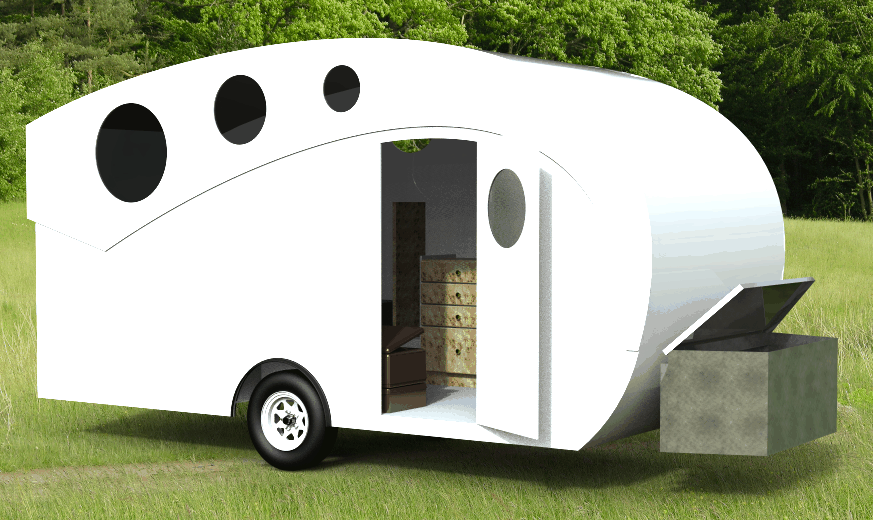

Postby mikeschn » Sun Sep 27, 2009 12:43 pm
I just did another rendering... now the Alto WW is painted silver...
I also added a couple storage access doors under the bed, one on each side.
I have some other stuff to do now... hopefully I can get back to the renderings this evening...

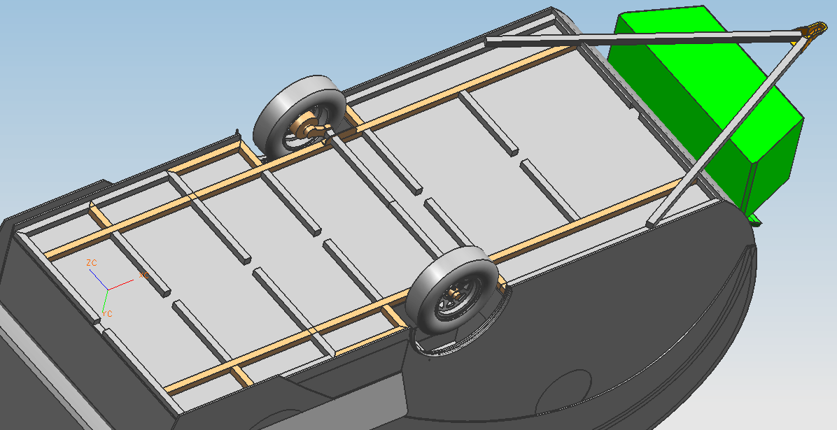

Postby mikeschn » Sun Sep 27, 2009 1:19 pm
Carter wrote:What's that 1600 pounds in the spreadsheet, 1000 trailer and 600 stuff?
Obviously my dream of a 1000# trailer is a pipe dream. The alto, optimized to be as light as possible, was 1600#. So I'm just trying to be reasonable...
If the trailer, dry, is 1600#, and I have a towing capacity of 2400# on the tow vehicle, maybe we can split the difference, and add 400# of shtuff...!!!
:lol:
P.s. I didn't really optimize the chassis yet... but here's a screenshot of the mess I have right now...

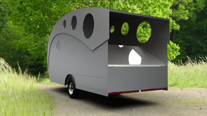

Postby mikeschn » Sun Sep 27, 2009 2:21 pm
Here's a shot with the back wall folded down, before the hatch is lowered...
P.S. there is a slight design question... what to do with those triangle pieces... any ideas Scott? Gary? Jim?
