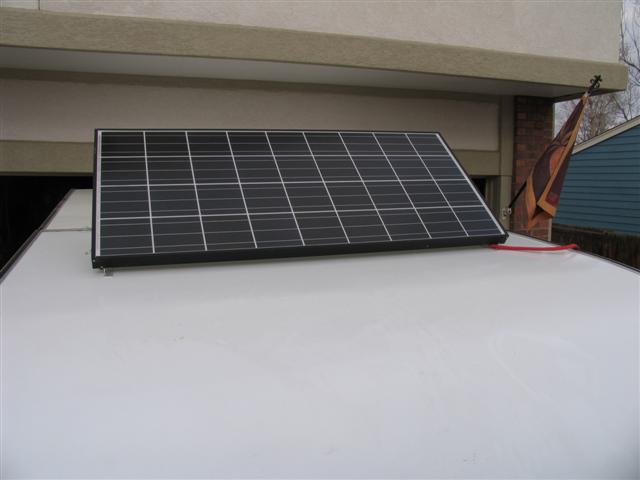

I have the same panel, you can't go wrong with that one.
Its a different color than most panels, supposed to be a more appealing. Whatever, it's the 135 watts I'm interested in! It has MC4 connectors, you might check and see if you'll need any to install it.
Its nice that the controller has metering. I think its important to have some kind of metering so you can tell what's going on with the panel. I can tell if there's a shadow on the panel using my meter.
Make sure and post some pictures of the install!

Thanks for the headsup. I am one tongue box and dry weekend away from doing the install. I double checked and sure enough plenty of cable and no second MC 4 Connector. I am half tempted to cut them off and spice in the cable but can see the power of using a connector.
What do you think of a disconnect tool? Like http://store.solar-electric.com/ditoformc4co.html
Does a standard crimper work or do I have to get a special crimper as well?
You can get the MC4 apart without the special tool but its a PITA and you might break the connector doing it. I bought a male-female pigtail cable from eBay and cut it in half for my panel. The MC4 crimpers are high dollar, dunno if a regular crimper would work. I almost cut my connectors off too, I still might if I ever redo the wiring...
