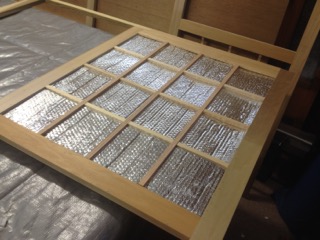

Sidewalls are insulated with reflectix so not translucent.

As I said, i used reflectix bubblewrap, two layers midway in the 3/4 inch skinwall. With 2 air gaps and two reflective layers with double layer of bubbles it makes a reflective, high R-value wall. The only heat gain I get is from my 2x4 foot skylight and that is easily dumped using my solar powered vent fans. It is very cozy and easy to heat at night.

Two layers of reflectix captive within the rib structure before skinning.
Here is a detail pic of the sidewall showing how the insulation was done
