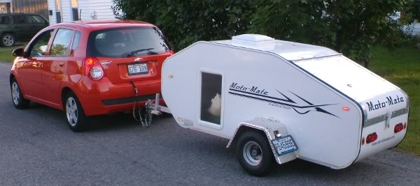

Postby legojenn » Fri Oct 11, 2013 12:53 pm
Below is a photo of my trailer. I bought this trailer in 2009. Replicating this is something that you might want to consider if Her Majesty will let you put it on the roads. This little thing weighs in at 330lb/150kg. The trailer is 7.5 feet long, and 3 feet wide. The wide tyres keep the trailer stable on the road. The cabin has an aluminum frame and is coated with aluminium walls. The inside walls are plywood with foam in between. The trailer is very simple. It's an aluminium T with torsion axles.
I tow it with a Chevrolet Aveo with a 1.6L engine and don't notice the trailer. A powerful bike or trike should be able to drag something that small. It has no galley, so a lot of the weight that other trailers carry is not there. It's so light that it does get airborne when I'm pulling it on less than perfect roads at high speeds.
I hope that you find or build something that suits your needs.

Jen I really like the look of your trailer :D
Do you have any side on photos? Does it have a rear hatch ( I think I can see one)?
I have been reading up on bolted aluminium trailer structure tonight and have ideas :thinking: There is a lot out there on aluminium boat trailer construction.
