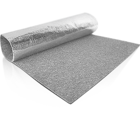

Postby working on it » Fri Oct 18, 2013 2:29 pm
kd5edj63 wrote:I think I want to go with a weekender type design. Im wondering if I should go with a "hallow" roof or a solid three quarter inch birch roof. The only thing I might like on a hollow roof is that it could be insulated. Does anyone have any advice on this. I might plan my build one more week before I dive in
Having a trailer with no insulation and of 3/4" plywood...my answer is "I don't really know". I've only had it out for a weekend, and it was cloudy one day, and cool and wet the next, and cool the third, and I had a canopy overall the whole time.... My plan was to (mainly) keep the Texas Sun off of it; no insulation needed in the Texas climate. I painted it with a reflective aluminum on the top and rear and front sloped roof, to reflect heat away, but have no valid test results to share (it's in the garage when not in the wild). My only test results I have are from heating or cooling it while in the (unheated and uncooled garage). When testing the A/C there, It retained the cool for many hours, even up to 100 degrees ambient; when testing the 200 watt heater, in 30 degree weather, it heated up and retained that heat well. Of course, in the garage, it is not exposed to sun, wind, or rain that can effect it. Prior to buying the canopy, I had bought some insulation for the ceiling,
http://bondedlogic.com/construction-products/ultratouch-radiant-barrier just in case it was needed ($ 20 at Home Depot online), but don't yet know if I'll use it. On the other hand, I did notice the coolness of the A/C being transferred thru the walls, when I left the A/C running to cool my already prepared food items (for that night's camp gathering). In the humidity outside, the walls were sweating. So I bought some rubber-backed carpet (same as on my floor) to block that heat/cool transfer. I haven't installed it on the walls yet, so no tests possible. Just my observations; another is that the 3/4" un-braced roof is still flat, and hasn't drooped in the 1.5 years since it went up, but is only 54"x48". For a larger piece, I would put supports under it (I have room available to do so in mine if necessary).
