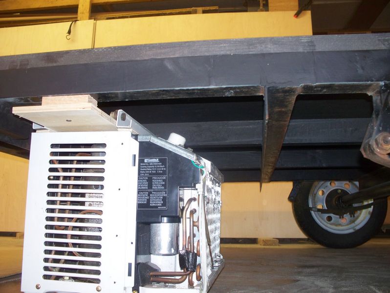

Ready to do something a little different than seen on here......
This will slide to the center and meet with ducts....probably use some closed cell foam type gasket configuration...

oakinteriors1 wrote:Ready to do something a little different than seen on here......
Now,that is definately thinking outside the box!

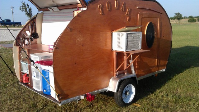

Todah Tear wrote:Image
I came really close to doing mine like this. Inside it would sit in a cabinet. Open hatch, slide out on drawer slides, use it, done slide in, close hatch. I would not have had the outside braces though.
In the end, I couldn't give up the inside cabinet space. I put it above my bed headboard in a space not being used by anything else. This is what mine looks like inside before I finished it. All painted and trimmed now.

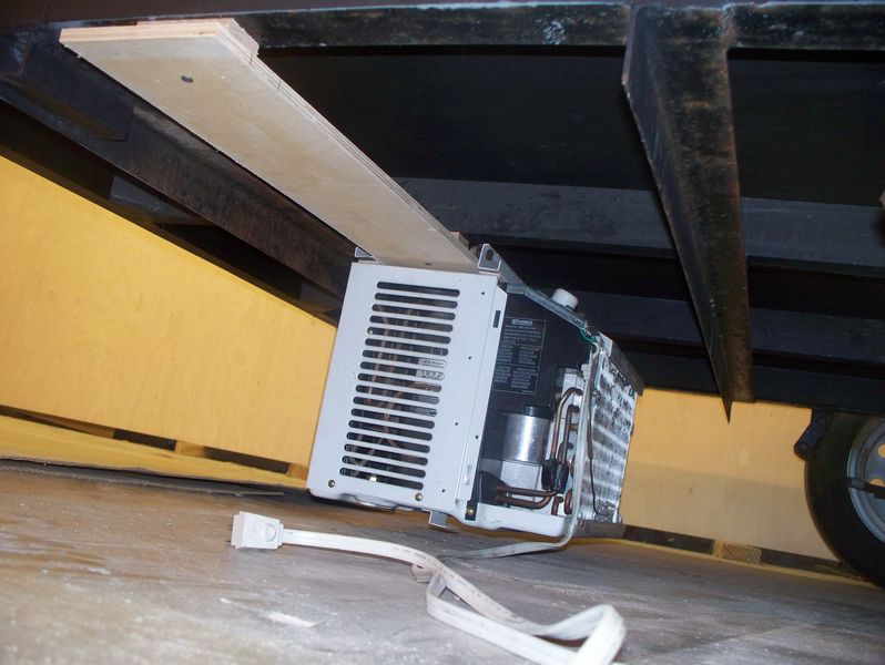

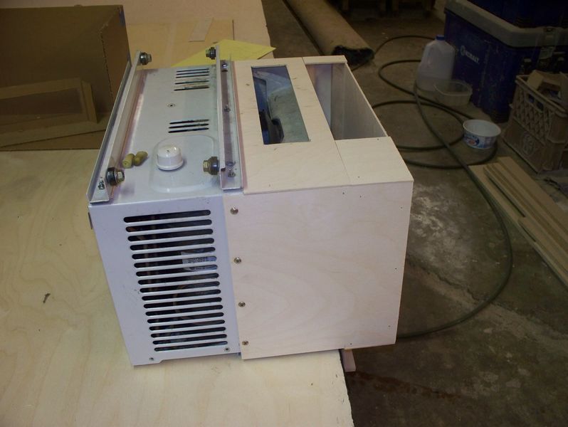

Postby oakinteriors1 » Sat Nov 09, 2013 7:30 pm
Up into the galley from underneath..
And into the cabinet, the return air duct is on the bottom..
More later...
