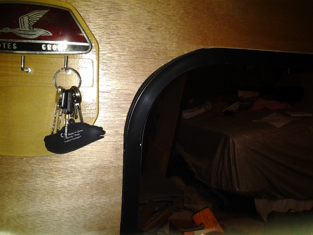

Sheddie, did your doors come with an interior trim ring?

Hi Laurie,
There was no interior trim ring, but they did include a self adhesive foam seal which we assumed was to trim around the inside to hide any gaps. As our walls are quite thick, they are almost the same as the frame of the doors, I was going to make a thin wood trim to go around it. The cut out was not too bad and with the black frame any gaps are not noticeable.

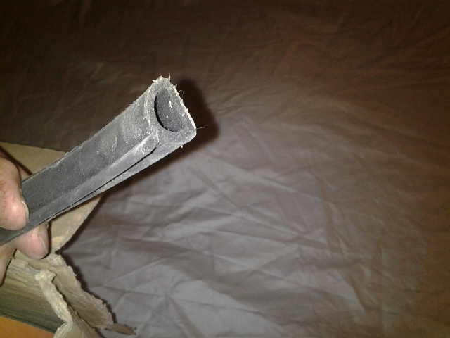

If you end up with a gap around the edge you could possibly use something like upholstery piping or fender welt.

Have to make a very careful cut on the template.

The lid off the box they shipped them in was an ideal piece of ply to cut the template. Initial cut a bit small, then trimmed for a neat fit. Traced that on to the walls and again cut a bit small then trim to fit. Difficult bit was that the walls were already standing before our doors arrived. Big thing is, just take it slowly.
