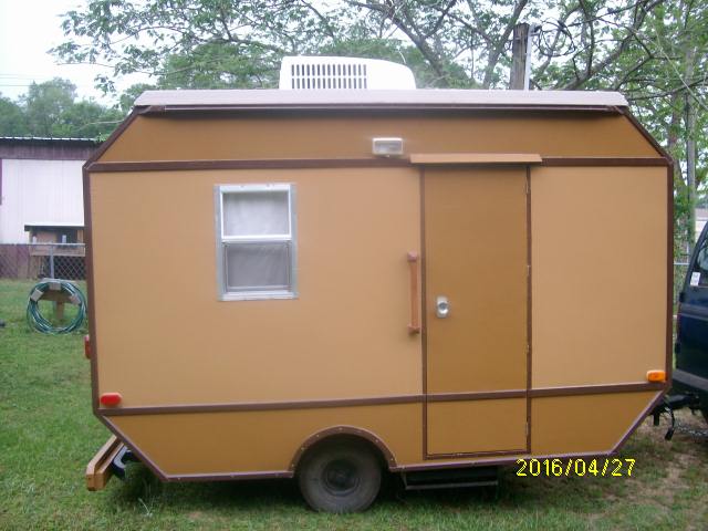

Postby snapper388 » Sat Apr 30, 2016 11:16 pm
I built mine from an old popup. the popup had a lot of the things I needed . a/c, converter, door lock, lights, porch light, marker & tail lights and a few other things, I also ripped most of the framing from used and discounted lumber.

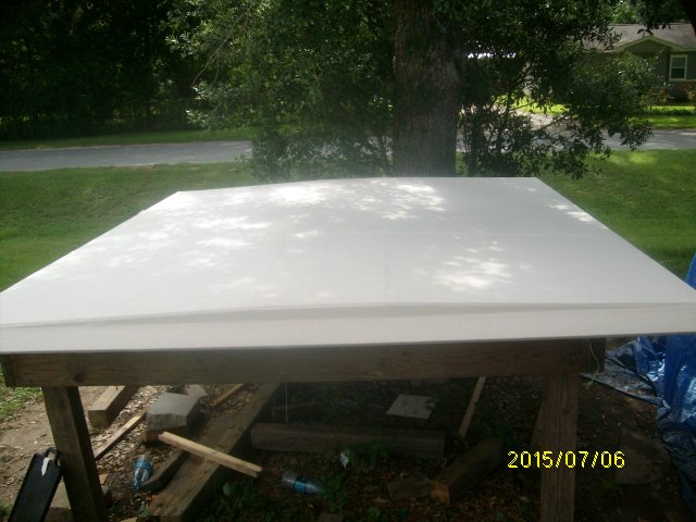

Postby rustytoolss » Sun May 01, 2016 10:49 am
snapper388 wrote:I built mine from an old popup. the popup had a lot of the things I needed . a/c, converter, door lock, lights, porch light, marker & tail lights and a few other things, I also ripped most of the framing from used and discounted lumber.
Did you reuse the old popup's roof /lid panel ? How much does it weigh ? Wood/foam info. :thinking:

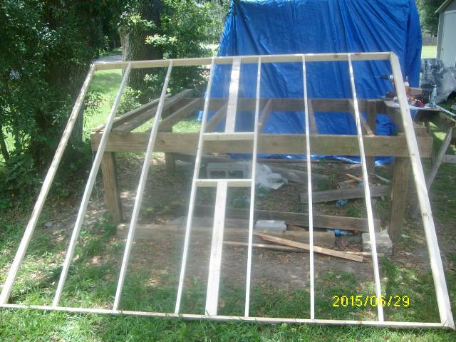

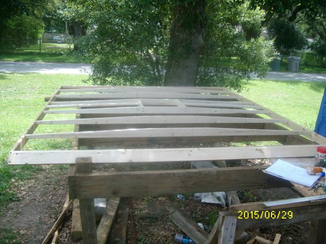

Re: Realistic budget ?
Postby snapper388 » Sun May 01, 2016 1:02 pm
I framed the top with 1x3s and 1x4s , I used 2 1x3s next to the a/c, 1x3 framing on end walls, 1/4 luan for sheathing and used titebond 2 canvas and paint.the walls are framed with 1x2s and 2x2s with 1/8 luan interior and exterior walls and ceiling, 1/2'' Styrofoam insulation. I have not had it weighed yet but I estimate between 800 & 1200 pounds.

Postby rustytoolss » Sun May 01, 2016 2:30 pm
From the completed photo. The top looked to be from the popup.
