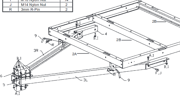

Postby mikeschn » Sun Jul 17, 2016 11:51 am
I dug around on the internet to find these 2 pictures...
The first picture is the original design, and what is present on my HF trailer. The bracket is bent into the shape of a channel, and a bolt goes thru both legs, and thru a single a single wall of the tongue...
This appears to be a new design. I found it in the instruction manual on the HF website. It looks like they've got a long piece of angle iron now. So the bolt goes thru on wall of the angle iron, and one wall of the tongue. This design eliminates the collapsing of the bracket that is present on my design. But I'll add a sleeve, and we'll be fine. But first we'll let the welder look at it...
Anyways, there's no way to capture the tongue inside the bracket on the original design. I suppose one could fashion a new bracket...

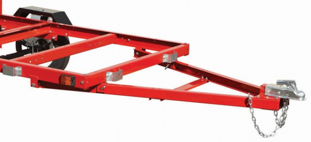

And I remember reading this years ago on http://redtrailers.com/WhyRedTrailers.asp website:
Notice the difference in the tongue design. RedTrailers have a center tongue support tube that provides greater strength (and greater safety) while towing. The RedTrailers coupler is securely mounted to the end of the 50-inch steel support tube, while the "Brand X" coupler is simply bolted to a lightweight flat metal plate.
And red trailers is willing to sell me the parts to make my HF trailer look just like a red trailer. I might do that...

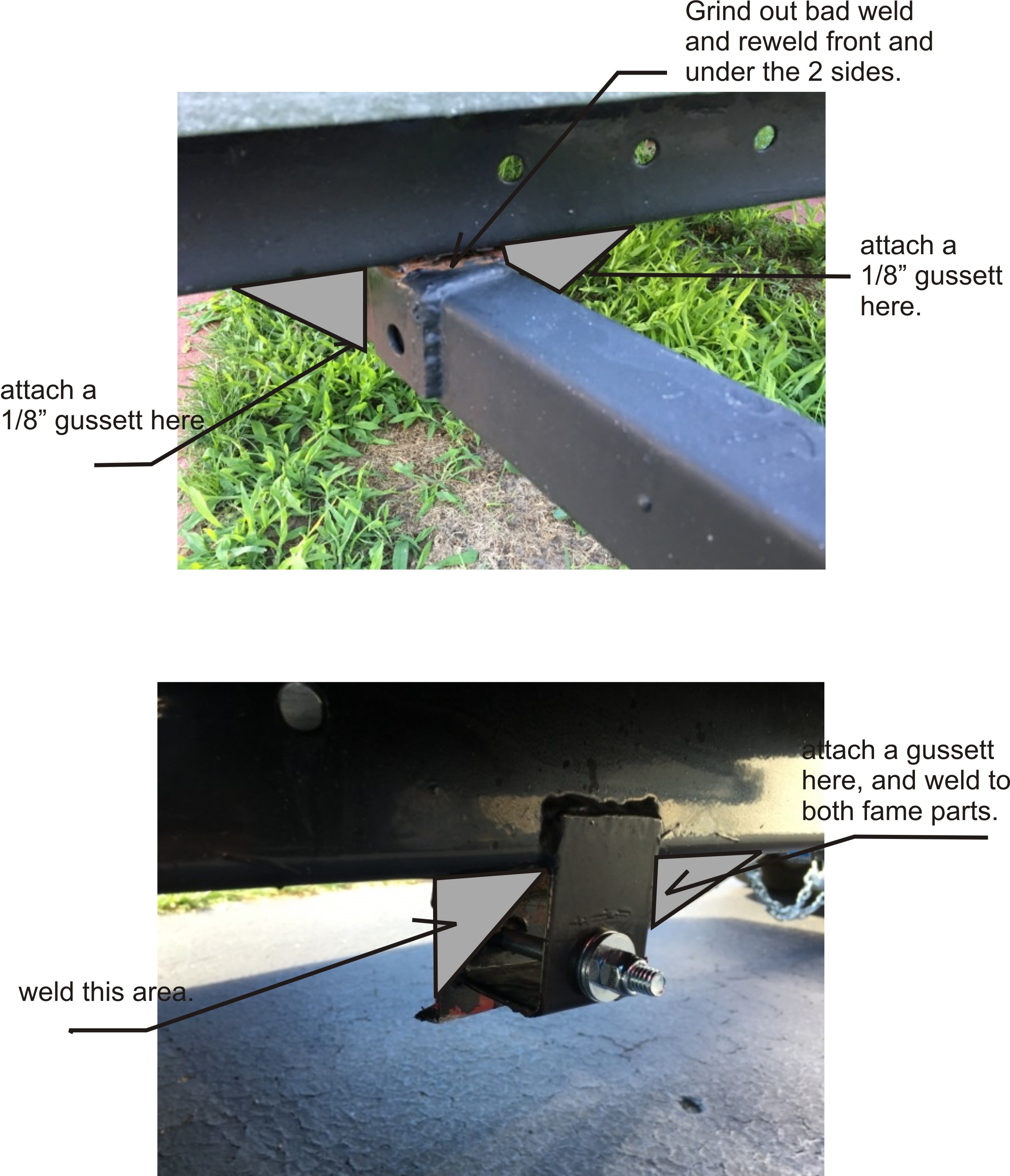

Postby R. W. Alexander » Mon Jul 18, 2016 9:23 am
It was a improperly welded part. Or what is called a "cold weld". The up and down movement of the tongue while driving on the road gradually weakened the bad weld until it broke. a simple clean out and re-weld along with some gussets will fix the problem. The Harbor Freight trailers are not bad, but welding the steel frame at key areas, can prevent future problems. With a bit of monthly frame checking during the trailer season, problems can be avoided. For me when I get a trailer I get rid of the bolts and just weld and reinforce the areas where the bolts were. It's peace of mind for me.
