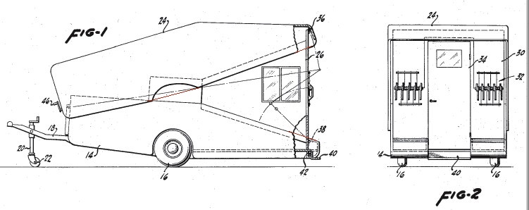

Well, the design is probably not going to be the same. I'll start off with the sketch that Barrie posted from the patent design, and then try to modify it for foam.

Not sure what you mean when you say "Original Clamshell design". I didn't have a chance to work on a new design this weekend, but I am hoping to come up with something that works with the hinge in the front.

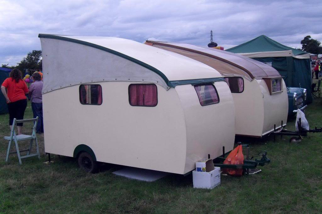

Here is a Wessex from the 50's

Postby GPW » Mon Jul 30, 2018 4:52 am
Mike , the drawing at the top of the page … ^

Are you going to model the front "hinge" of the vintage design? It seems to be complex. The video link to the showing the camper on a game show doesn't work any more, but I believe it showed the front part of the roof "lifting" first and then hinging. I think that is the reason the vintage trailer was compact in height.

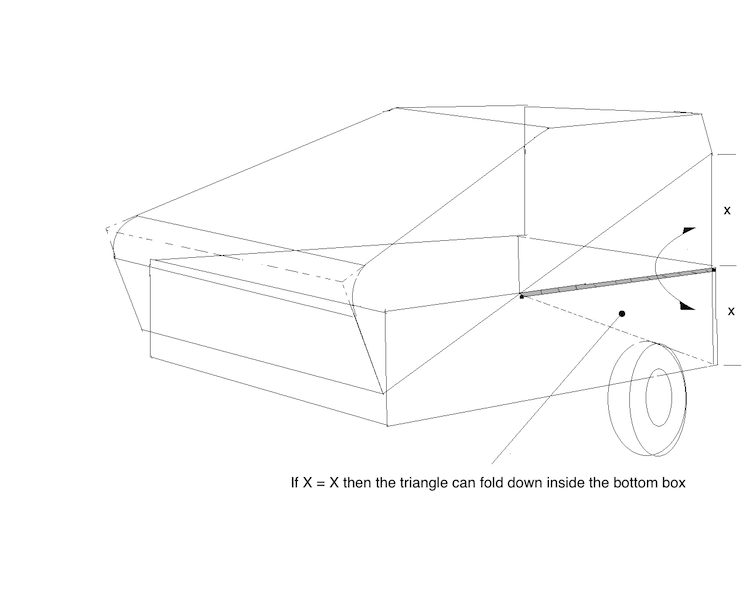

Postby GPW » Tue Jul 31, 2018 9:16 am
Just a possibility ...
Re: Fold Down Trailer?
Postby GPW » Tue Jul 31, 2018 11:17 am
the quartering view … :thinking:

Postby mikeschn » Tue Jul 31, 2018 5:07 pm
It's not as easy as it looks...
My first peek.... is similar to what Glen did, sans the boat... I started with a 16' long trailer. Filling in the sides with a wall is going to be interesting...
That phantom line is 70" standing height!

Mike
For the back wall to be straight it will have to be forward at least a foot with the hinge that far down. If you look at the pics of the original trailer the front goes up a couple feet as the top goes up. that way the back wall geometry works. Remember what we learned with the WW rockhopper work. The hinge height has to be half way between the up and down height of the back of the hatch levels for the back wall to be straight. They got around that by raising the pivot point as the top went up.
Gary
