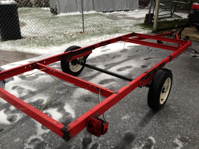

I've stretched the trailer to 10 1/2 feet. The axle is 55" from the rear. Now to solidify the design... :D :lol:
Notice the welds? Courtesy of the local Muffler Man! ;)

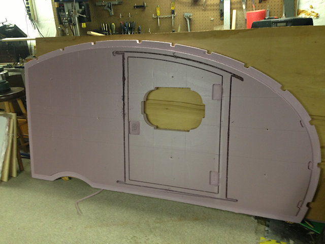

I started cutting foamie panels for the mad dash today.
But you can call me the foam butcher...

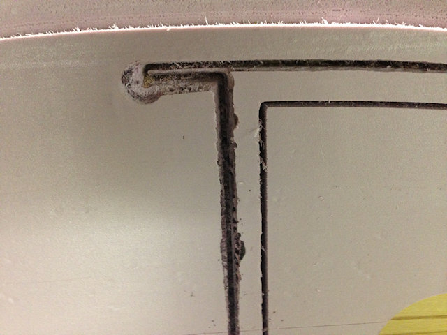

Here's the panel I cut...
Here's a closeup of the panel that melted...
Here's what the bit looked like
Re: The Mad Dash begins...
Postby Fred Trout » Sat Jul 11, 2015 8:42 pm
Huh ... what caused that failure to launch, Mike ? :shock:
Looks like the bit wasn't making clean cuts before it had a meltdown ...

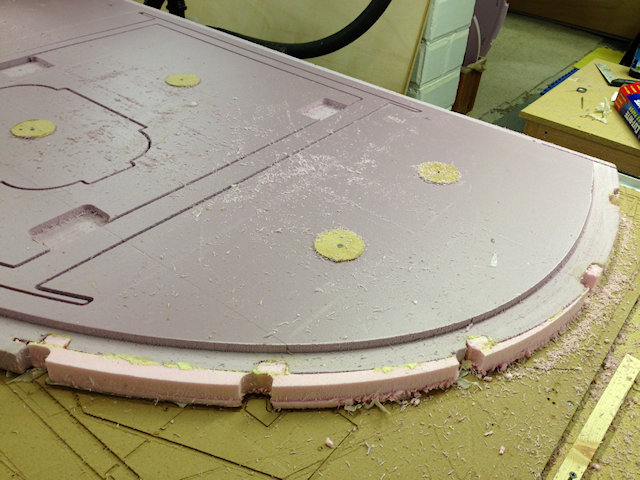

Yea, I must have been running it too fast. I slowed it down a bit, and the second side was coming along nicely, until the final cut. The part that I was trimming off was not secured down to the table. It popped up and snagged the router, and I lost a bunch of steps, to the tune of 1" in some areas. I have photos... give me a sec.

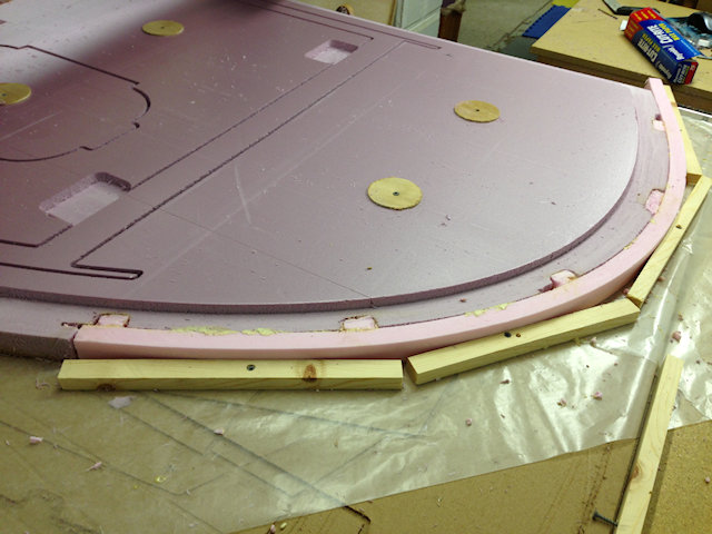

But thanks to Glenn, who constantly preaches homogenous materials, I glued some scraps in, and I'll try cutting it again...
Postby mikeschn » Sat Jul 11, 2015 10:17 pm
okay, here is the homogenous recovery...

It's the standard 2" EPS they sell in the orange big box. It's got 250 stamped on the edges. Owens Corning Foamular 250.
Today I am going to cut the tails. I can cut both tails from one piece of foam.
Then I am going to draw the hard edges and cut them out. I hope I have enough time to do that all today. It sounds like a full day!
