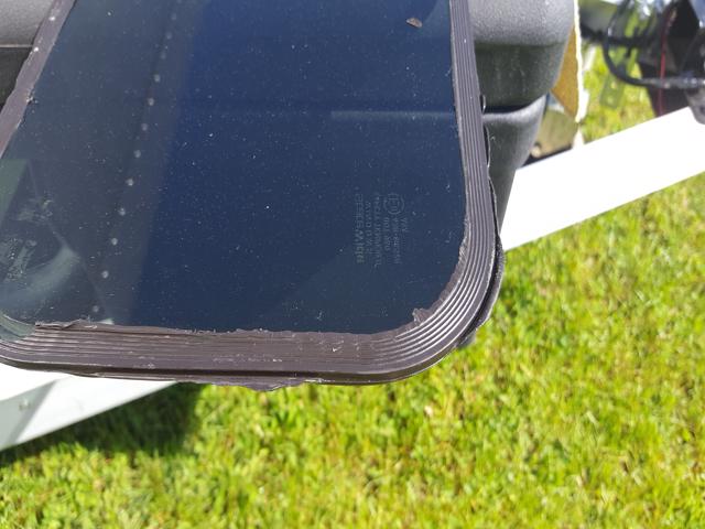

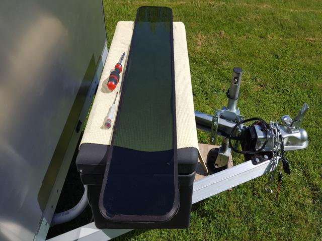

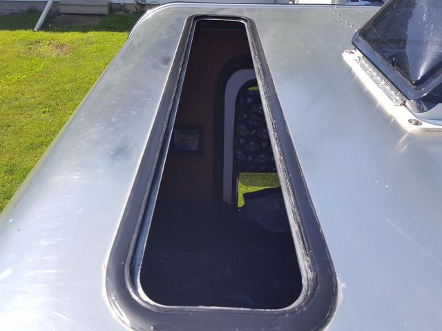

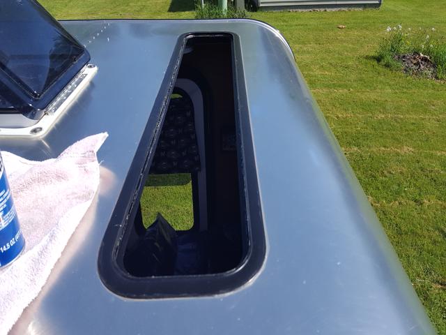

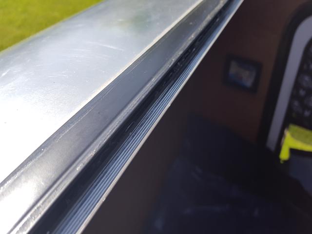

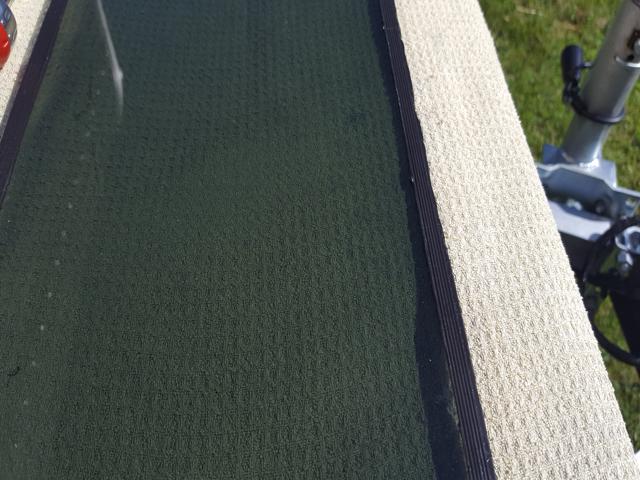

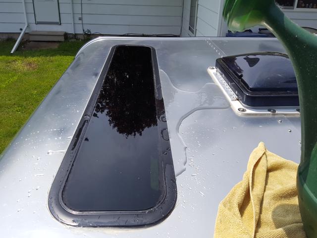

Update: Leaking again!
Over the weekend we had pretty heavy rain. The window(I thought) was dry until I ran my finger around the inside trim and glass. Wet finger! Previously it was only leaking in one corner. Now , it was leaking around the whole frame.
The more I ran my finger around, the more water I felt. When I pressed against the glass, more water leaked. It was almost like the silicone was not adhering to the glass(so I thought).
Sunday I tore into it. The window pulled right out of the frame. I just pushed on one corner and continued to push around the entire window and it popped out. NO TOOLS Required. I was amazed! It was adhered to the window but not the frame. I don't know if maybe I the window frame was not clean enough or why the silicone did not adhere to the window frame. Upon inspection, some of the dried silicone felt greasy and other areas felt dry. I don't think I did a good enough job cleaning the frame after removing the old silicone in some areas. But....If you look at the pics, the silicone had a perfect imprint of the window frame. I'm thinking the silicone won't adhere to the paint or powder coat that is on the window frame.
I might regret this, but....I cleaned the frame. Then, I used some brake clean and a brass brush to remove the paint/Powder coat down to the bare aluminum in the window track. I'm hoping the silicone will bond better to the bare aluminum and groves in the window track.
I'll let it cure for a couple of days and report back.

Re: Stargazer Window Leak-Caulk???
Postby Minics04 » Mon Jun 03, 2019 7:04 am
More pics
Postby Minics04 » Mon Jun 03, 2019 12:43 pm
Leak Test-Passed!
The window seems very, firmly, in place. I think the silicone adhered better this time with the paint/powder coat removed from the window frame.
We have rain forecast for tomorrow. Should be the final test!
Postby Minics04 » Mon Jun 03, 2019 5:18 pm
Do you know if it was leaking from the seal to the glass or from the seal to the frame?
I really feel it's the paint or powder coat used on the frame that keeps the sealant from adhering to the frame.
Postby Minics04 » Tue Jun 04, 2019 6:37 am
I agree with using good sealants. I used ProFlex RV sealant to seal the frame to the coach(Very happy with this). I used 100% Silicone from the window to the frame based on a manufacturer's recommendation. If it still leaks or starts to again, I will use 3M 4200.
The problem is between the glass and the frame not the frame to the coach.
The glass just gets adhered into the frame with sealant. Nothing to hold the window to the frame except the sealant and a rubber trim gasket on top of the glass.
In my latest fix, I though about leaving the rubber trim gasket off and instead sealing the topside of the window with sealant also. I have not done this but might in the future.
Yes, the windows are junk. I might look into tearing it out and designing some kind of replacement. Maybe a double pane Polycarbonate window arrangement.
