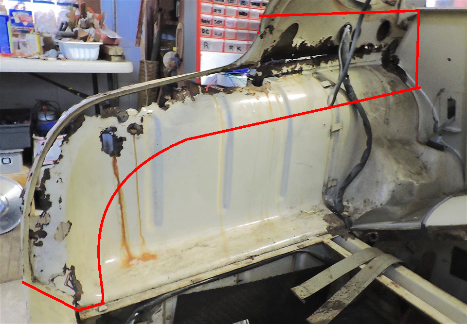

Philip asked .. “ What panels are you replacing on the car? “ Things like this … cutting out rust replacing the rusted area with clean metal . Sorta like this ..( see pic ) … all just thin metal ( not as thin as new cars ) I just want the MIG for tack welding the panels on , and will finish with a friends TIG …

I would still look for a 140 at the smallest. I have welded many hundreds of hours on many different welders. I have found many of the low end welders have problems with the mig liners. Poor quality right out of the box. If it will not feed wire properly you won't even tack weld. If I was looking for a welder used or new. I would be looking in the Hobart/lincon /miller brands. Stay way from a Clarke brand. I haven't found one of them yet that will run at top rated amps.
Another reason I am saying 140 amp. Most of them run .035 wire. That I the easiest wire to find. If you get one using .020 or .025. A lot of places might sell the welder. But they do not sell the wire for it.
Inner wheel house. You got some work there.
