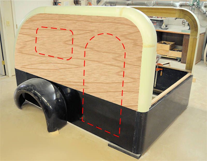

If I were going to finish this off as an actual official teardrop, I'd do a side door (or doors on both side) and maybe a window like the illustration below, and then I'd do an actual teardrop galley in the back, with a Jeep-tub tailgate and storage/drop-down table on the tailgate as I showed.
But since I'm just doing a proof-of-concept assembly and probably won't actually finish this to the point where it could go on the road, what I'm doing is verifying that all the TrailTop parts assemble and work as designed. I haven't decide how far I'll take the proof-of-concept project; I will definitely get a curved galley hatch built and hinged to prove that... I'm putting a finish on the mold masters for both the hatch ribs and the 12" radius skin section today, so I'll be making those molds very soon. And in the next few days I'm going to pick up two sheets of 1/8" baltic birch for the hatch skin, plus some other materials for it, so stay tuned, lots to come in the next week or so. I think I'll be using a "Better Than Hurricane" hinge for the hatch too :).
And, I have another prototype project I need the black Jeep tub for, so I don't want to cut door holes in it for this project ;).
