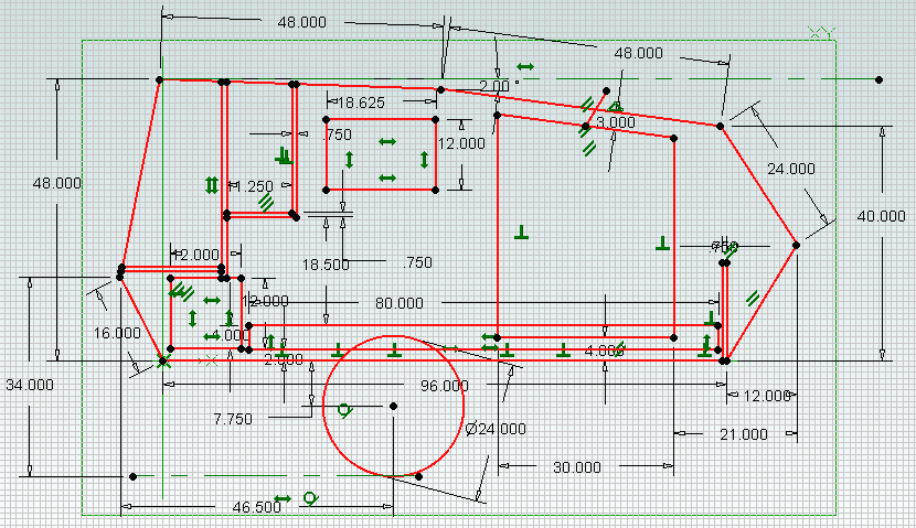

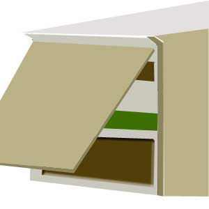

Glenn,
With my renewed fear of water, I decided to put the hinge for the hatch at the highest point possible. Then to further minimize the chance for water to get in, I made the hatch almost vertical.
Suddenly it's looking more like the rockhopper design I did a number of years ago... So I may have to change the name from Weekender to something else...
But for the moment, it's still the Weekender II

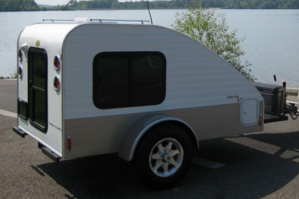

I dug out a few old pictures...

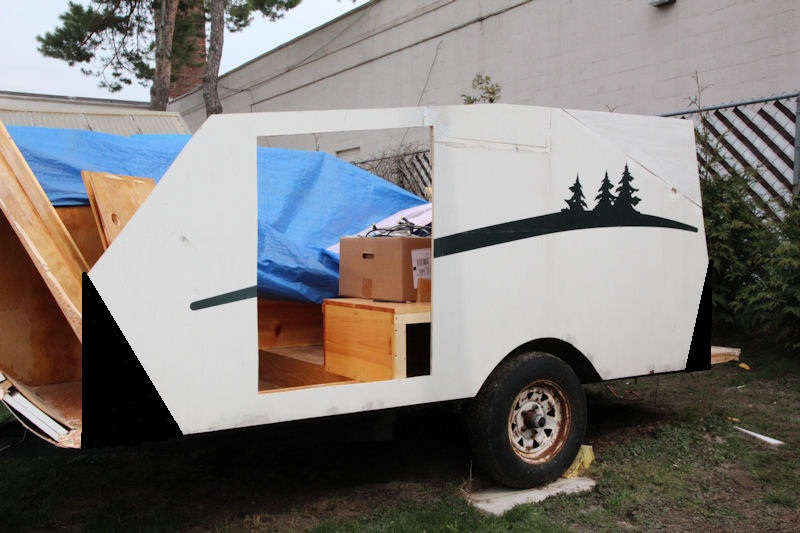

I mocked up a side wall of the Rockhopper II for Chell today...
Here it is...
She says it's too small. :cry:

Re: I think it's time to revisit the weekender.
Postby mikeschn » Sun Mar 18, 2012 4:58 pm
So she says, It needs to be 11 inches taller. :duh:
So I find a piece of wood 7 inches taller and make the modification.
She says she likes it... :phew:
