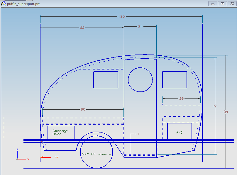

Postby mikeschn » Sat Sep 11, 2010 2:37 pm
Okay, just for fun, here is the Supersport, stretched out to an XL, with a galley out back.

Postby Carter » Sat Sep 11, 2010 2:38 pm
Mike,
I'm getting back into playing mode also. Maybe it's the fall like weather. I'll make it a 54" wide frame before I send it. Any certain length or axle placement you want?
The picture of the frame above keeps disappearing. If I log into the FTP site it's there and I can view it but the link for viewing it from the web is intermittent.
Jim
