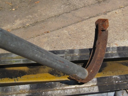

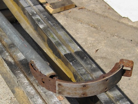

chgrsteve67 wrote:For some of the smaller pieces I made a sqare tubing bender out of a old truck brake pad and a 6 foot piece of pipe. A propane torch to heat up the tubing makes it more plyable.
For the big pieces I used two 1\2 inch sheets of plywood screwed together, cut out to the shape of the trailier, I made a lever that could be positioned in several locations that I used to pull the heated pipe around the template. I made several ancors so after its pulled around the template I could keep the tubing in place and then spray it with water. THis hardens the steel so it keeps its shape and puts out the burning plywood.

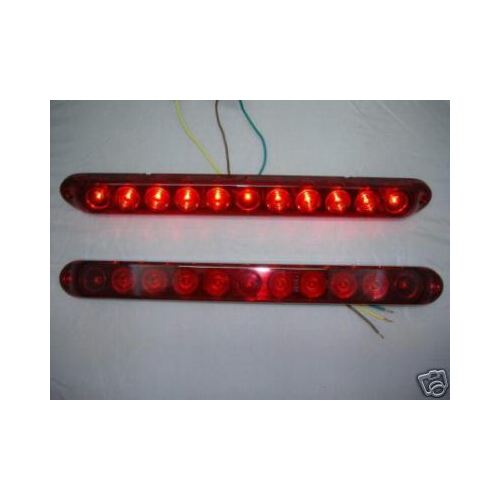

Are those Charger tail lights I see in there? What ever they are they're a nice touch.

The lights I use are slim 15 inch LED lights.
I didn't want them sticking out so we are working on making them flush with the rear.

Here are two pics of my hand square tube bender made out of a fence pipe and old truck brake shoe.
A picture of my frame template and bending bar.
There is a twist screw in the middle of the pipe so it can be adjusted to length.
The wheel and guide bar hang onto the square tube as it is bent since I used a torch to heat up the tube to make it easier to bend.

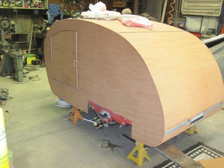

Postby chgrsteve67 » Wed Oct 21, 2009 11:30 am
Hey everyone sorry I have not been posting more updates.
Been out and about having some fun.
However progress has been made on the TT.
Pics
Some out and about pictures with some friends.
I will be going to the DMV tomorrow to see about getting my TT registered.
I still have a list of things that still need to be done.

Postby chgrsteve67 » Wed Oct 21, 2009 10:41 pm
chgrsteve67 wrote:I'm waiting to get my fenders before finalizing the door. It may get bigger or smaller.
Also remember I'm not building a camp trailer it will be a utility trailer to haul the luggage and car show stuff in. No kitchen.
No window needed.
