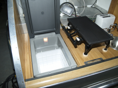

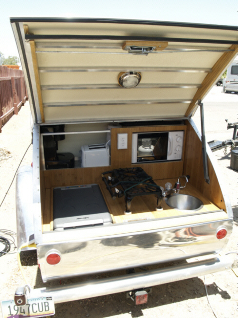

Yes.....ahem, I sort of got sidetracked for the last couple of months on this Modernistic project, however; the modernistic galley has a similar shape and size to the 4 wide littleguy. The modifications in the photos below would also work in the Little Guy 4 or 6 wides. We are working up some aftermarket galleys for these trailers when we get back from an extensive Road Test of the 1947 Cub.
Shown here with 12V 2 cubic ft. Freezer, Sink w/ city water hookups plus 7.5 gal fresh water reserve, galley light, microwave oven, vintage two burner propane stove, Coleman camp stovetop coffee maker, toaster, waffle iron and 110 outlets.
Closeup of open freezer and flat grill over vintage stove.
With a little thought and a lot of elbow grease you can fit just about anything you need into one of these.
