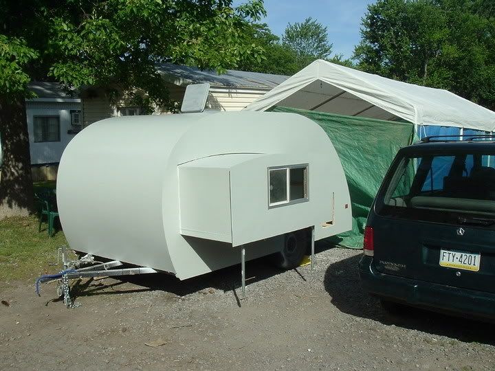

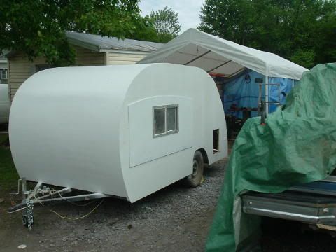

Postby Marck » Fri Oct 31, 2008 1:57 pm
Actually the slide out is a small bed for my 2 smallest daughter's to share, it's about 3.5' wide and 5' long
I made a sort of slide out roller system out of an old pair of roller skates. you have to hold up on it a little when you slide it out. but it's all good. I put the legs on it just to be safe.

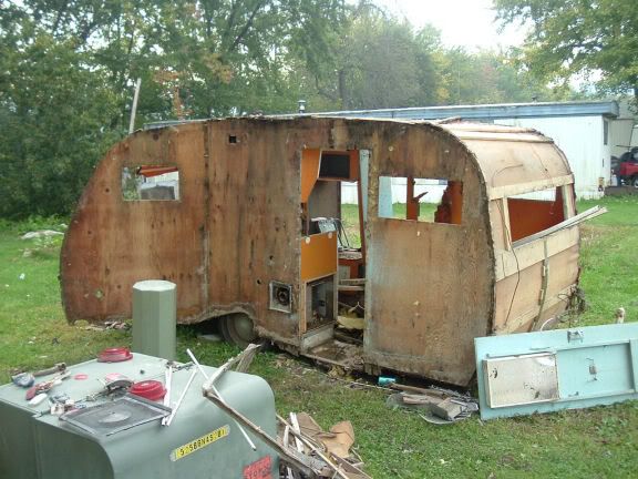

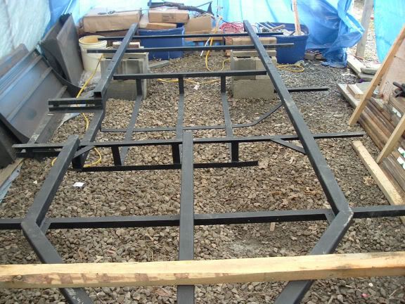

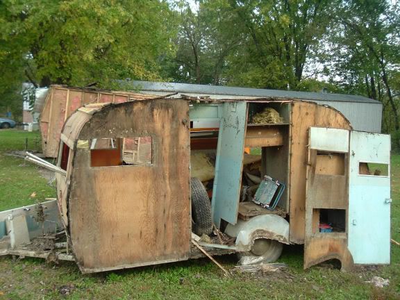

ok I fixed the link to my www, so you can see the construction pics. Yeppers it's a 65 scotty and the dropped floor is still in there.
Here's the scotty when I got it after it went through Hurricane Ivan in 2004.
The guy who retreived it from the River took the aluminium for scrap and I eneded up with it as you see it lol
Here's the frame after I cleaned it up.
and with the floor on it:

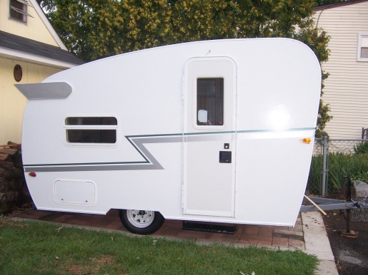

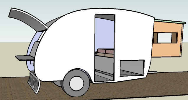

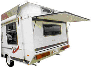

Have made a change to the profile: it's a bit taller, fuller in the rear, and leans out in the front, ala Shasta (though the nice roof curve is missing...). See the photo of Len's Shasta-clone to compare. The rear has a tailgate to access the area under the galley. I looked at other ways for the bed to slide, but it needs to cantilever from the middle when both out (open) and in (closed), so I stuck with the rollers in channels. And yes, it can be opened while hitched to the tow vehicle.
Found pics of the A'van Ray slideout, which is very similar to my plan, but theirs has no floor in the slideout; the floor and mattress fold down after the end is pulled out.
