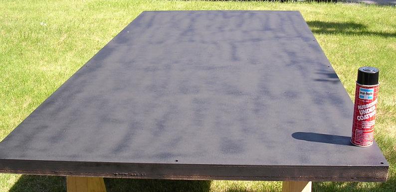

Postby The R/C Man » Mon May 30, 2005 5:43 pm
Hey all!
Well I rubberized the bottom of the floor. When it's dry on the trailer it goes and up with the walls.... :)

Postby Kevin A » Mon May 30, 2005 7:55 pm
The R/C Man wrote:Hey all!
Why are these pics not loading? Grrrrrr... :x
Greg,
If you change this word http://tnttt.com/album_page.php?pic_id=1629 to this pic
before you post it, your pictures should show up.

Thanks, Steve. I'll have to take a look. I don't mind buying poplar for this, but did you use poplar for the rest of the spars too? I have to buy insulation this coming weekend, plus the spars, plus a brad nailer--so it's going to be an expensive weekend.
And Greg, what was that stuff you used in the can? You used that instead of the roofing asphalt? That looks a heck of a lot easier to work with.

Postby The R/C Man » Tue May 31, 2005 10:12 am
IraRat,
It is a rubberized coating used for the underside of cars. It is supposed to repel water etc. It was only $2.50 a can. I used two and that barely covered it. Three would have been better..... You can get it in automotive stores......
Oh yes, it was very easy to spray. Start to finish maybe 15 minutes....
