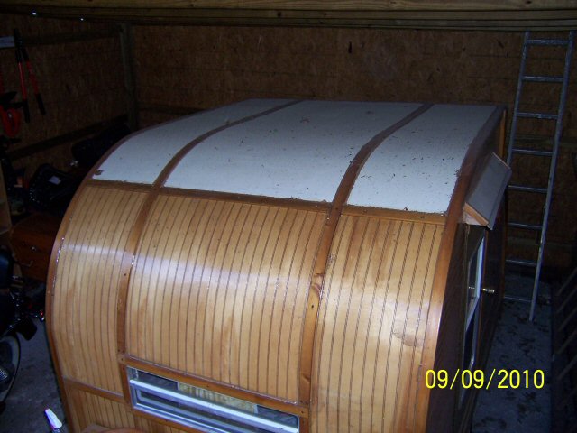

I think I will mechanically fasten mine as well as using 3m trim adhesive.
When I installed the lexan roof on the big teardrop I used these....
Right left and center of every 3rd spar and have had no issues at all. I predrilled oversized and placed a blop of 100 % silicone down and screw in the rosette hand tight ( snug ).
I had concernes with just using glue. That is asking a lot with extreme temp swings so the little extra insurance , I felt , was a good investment.
Spaced uniformly they look nice and add a bit of eye appeal .
