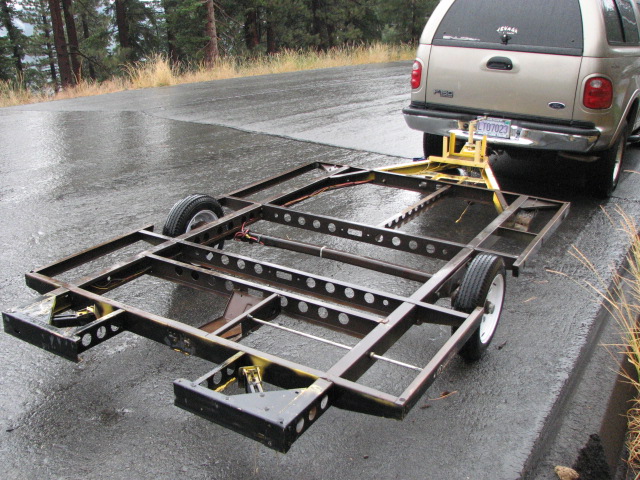

In mid July, after what seemed like the longest snowiest winter ever, we dragged the frame into my neighbors' shop for some modification work.
Here it is as we literally dragged it up into his shop because that's where his welder is. We moved the axle back, ground off some unneeded fittings, replaced the nose wheel, straightened the mounts for the axles and fixed some poor welds

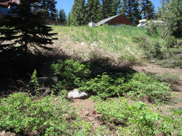

Here's the hill off of our street that we had to lower it down to get it to his shop door

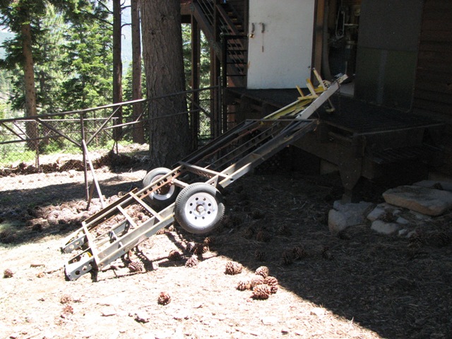

That's the tip of the three story roof of my house across the street that you can see in the background of the photo. And yes, we had to lower the frame out of his shop and pull it back up the hill to get it back to my house.

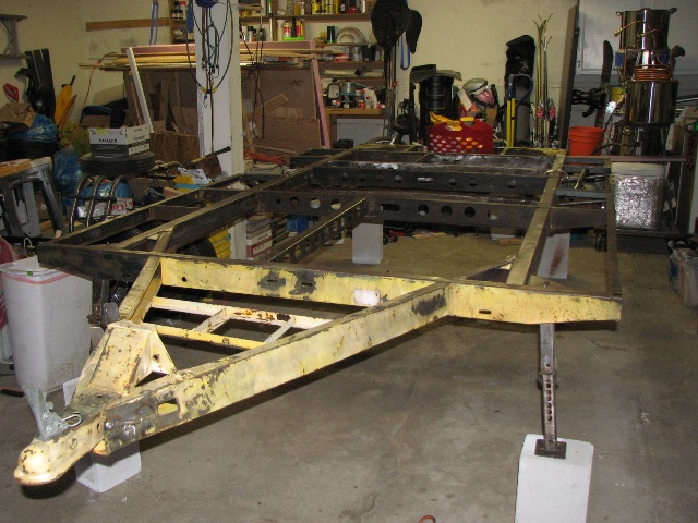

So here it is today, sitting in my garage.
After 12 hours of wire brushing, it is now ready for primer and paint. That will happen tomorrow. Yup, there's a lot of stuff in that garage. I just finished a complete bathroom remodel of our master bath and I didn't spend too much time cleaning up before getting to work on the trailer. I just wanted to get going on the build!!!

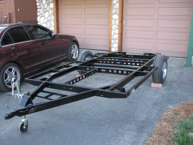

Got the frame primed and repainted. Man that is one messy job, but I am pleased with the way it turned out. Here's what it looks like now

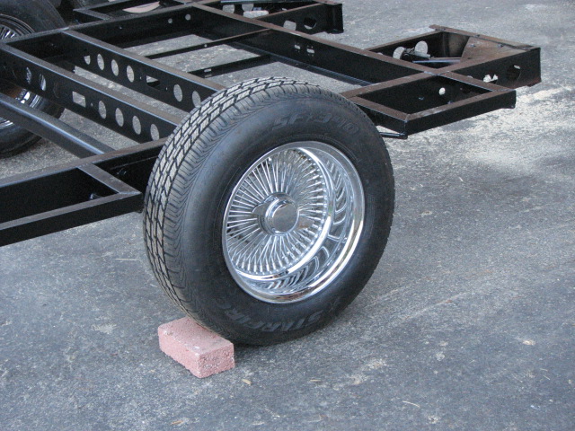

I also mounted the new wheels and tires
I went to 14 inch wheels from the original 12 inch wheels it came with. I got them off of Craigs list, bought four and sold two of them off to someone else on this site. I now have 12 inch wheels for sale. Anyone interested?
