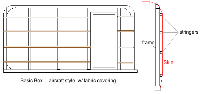

Postby GPW » Sun May 30, 2010 7:56 am
Here's a simple Box done aircraft style ... just as an example ...

Postby GPW » Sun May 30, 2010 8:45 am
As an alternative , you could glue blue foam panels between the framing members as per the usual... The spray foam would make a tight integral unit ... but I wonder if it would "puff" the fabric out on the outside ??? Probably it would "grow" towards the open areas and not be a problem ...
Sure would be Light huh !!!! ... and STRONG :thumbsup:
Posts: 14921

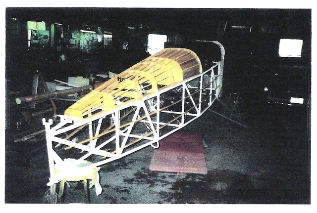

Postby GPW » Sun May 30, 2010 8:57 am
Picture of a typical fuselage framework Image

Postby Grid Runner Adventures » Sun May 30, 2010 9:02 am
the fabric is very ridged when the resin has cured I think the spray foam would expand to the interior and not be a problem aye.
