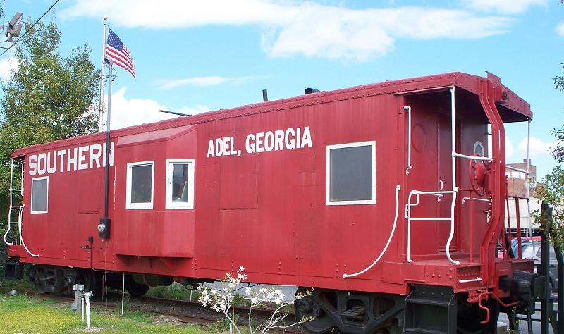

Postby GPW » Thu Nov 18, 2010 8:42 am
Just looking at those real caboose pics , gives a great perspective to a Trailer build ... The pics tell all ...
I'm one that thinks the cupola gives the distinctive look of a caboose (what we're used to seeing anyway) I remember as kids , we'd always wave to the Engineer, and the guy in the back hanging out of the cupola window...I still wonder what they were doing up there looking around.. ??? Maybe just enjoying the view .. :roll: America's Backyard !!!

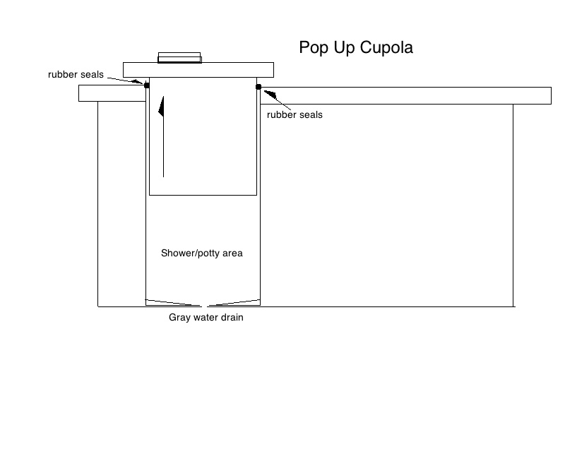

Here's my thoughts on a pop up cupola FWIW ... and if you're using that area for a shower , then it should be sealed /waterproofed inside anyway , so any small leaks would be inconsequential ... all draining through the floor drain to a holding tank or whatever... Instead of a slide out , a slide UP.. :thinking:
Postby planovet » Thu Nov 18, 2010 12:58 pm
The slide up was what I had in mind although the folding design is also pretty neat.
More ideas to ponder... :thinking: :twisted:

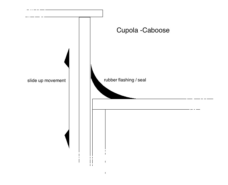

Postby GPW » Fri Nov 19, 2010 9:21 am
Was thinking more a box within a box ... (easy ) with some kind of rubber flashing , like a sweep gasket ...thingie" ...
Tried a hinges , mine leaked ... :o
With a tapered floor , any water that might get in would run down and out the drain ... For a shower , wouldn't we want to 'glass the insides , much as a home f/glas shower???
Only problem with a slide up cupola , is you have to mount the windows flush with the sliding part .. :o
