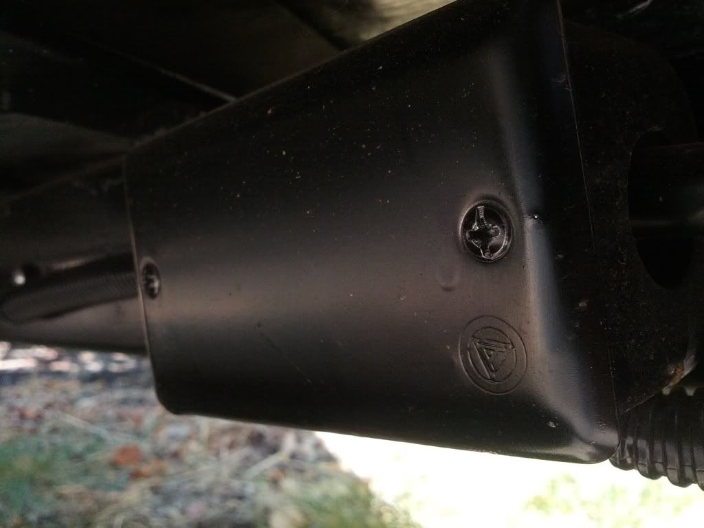

Techguy wrote:It looks like a "handy box". Take the cover off and take another photo. Normally it is used as a junction box for the wires.
