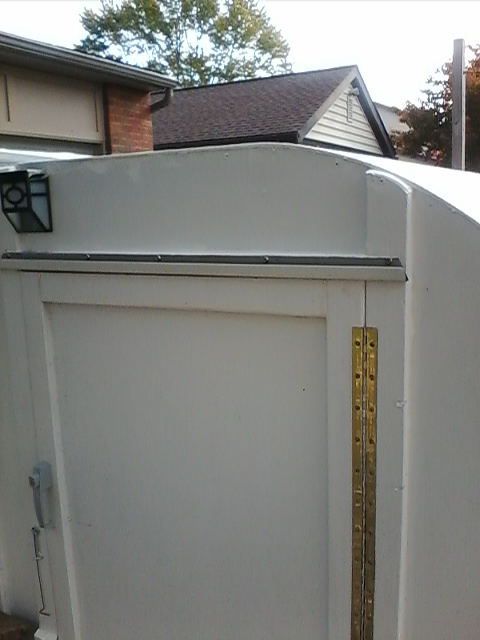

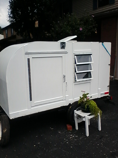

I like jalousie windows because of the awning effect and the vintage nature of the design. I was given an old jalousie window that I rebuilt and was able to find a new window to duplicate on the other side. Cheap too, $59 retail. Search for shed or playhouse windows. I really don't see much appeal in the Willey design.
I built my own doors. Super cheap and easy. I cut out the square door from the side. I used 1x3 s around the edge of the door with about 3x4" overlapping the edge. The door was pushed into the hole in the side and 1x3s were attached around the border. Hinges were screwed to the 1x3s and a gutter was screwed over the top. The resulting labyrinth seal around the door keeps water out.
I know this construction is too crude for many but it has worked extremely well for a cheap, light and water tight trailer.
