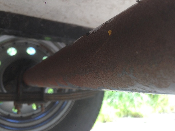

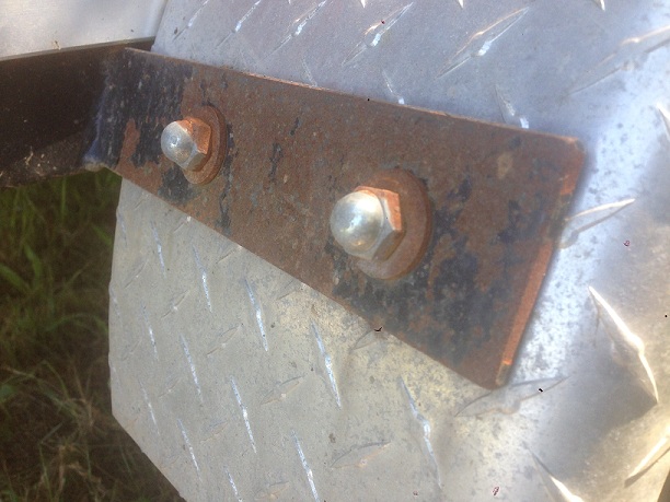

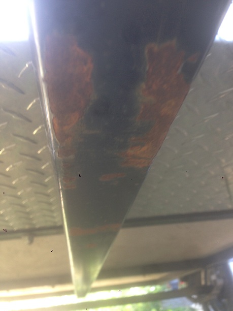

I'm becoming quite frustrated with this situation; this was supposed to be a fun purchase and now it's turning into a liability it seems. I have a lesser issue with the trailer that I'd like some advice on. It seems that the trialer bed is showing quite a bit of rust. not sure if this is a big deal or not but since the trailer is less than 90 days old I feel it's a bit unusual - is it something that I can fix with a good old can of Rustoleum, or am I destined for a long, losing battle with the rust monster? Paul I have resized the images! 8)
One of the images isn't that great but was the best I could do while crawling under the trailer! Thanks in advance for your advice!

Rust. Most of the metal on a trailer has a thin spray of black paint and will rust. Some axles and hubs seem to be sold bare so rust is the norm unless an owner gets a can of paint and brushes on a thick coat.

That trailer is OLD, like years old and left in the weather. No way I would keep it. Unless you got like some super deal.
If you decide to keep the trailer, wire brush down as much of the surface rust as possible and sand the paint. Coat it all with phosporic acid. This turns the iron oxide (rust) into iron tannate and turns it black. This gives you a stabilized coat to prime, then paint.
