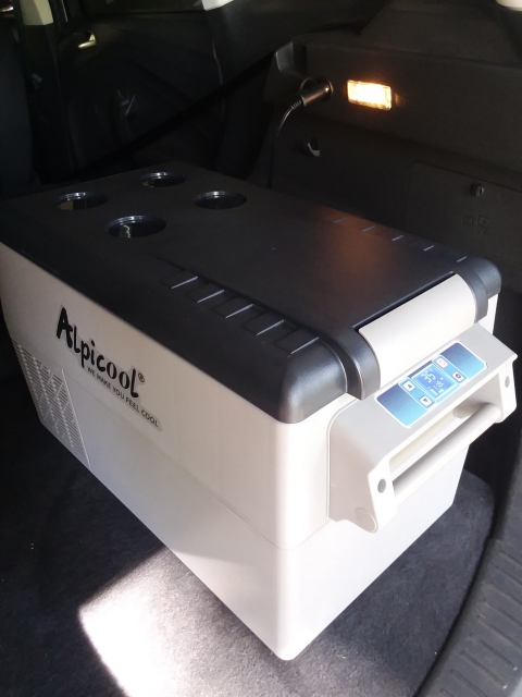

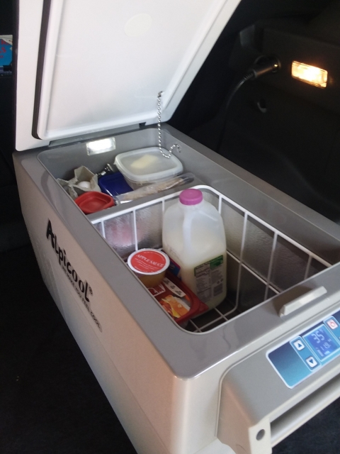

Received the fridge yesterday. Pre cooled it then plugged it in to a kill-a-watt meter. According to my crude measurements of the fridge running twelve hours on 110v it used 1 amp. At twelve volts that would be 10 amps, Correct? Not sure my calcs are correct.
So far it fits everything I need for a long weekend trip with room to spare. Waiting on the fan install until Cosmo gives his results of the 25mm fan and usb battery bank.

Postby absolutsnwbrdr » Thu Aug 08, 2019 11:55 am
It looks like the Alpicool CF35 is rated at 45W, so when the compressor is running it is pulling about 3.75A (on 12VDC), or 0.375A (on 120VAC).
Hypothetically speaking, on 120VAC, if the compressor kicks on for an average of 15 minutes per hour for 12 hours, your total (Ah) usage might be only be 1.125Ah. (.375A)*( 15min/60min)*(12hours) = 1.125Ah in a 12H period. So yes, if you were testing in an air conditioned house the cooler didn't need to work very hard, the 1Ah reading you got was probably correct.
On 12VDC, that would be... (3.75A)*( 15min/60min)*(12hours) = 15Ah used in a 12H period.
In real-world conditions (hot car or campsite) the compressor will need to cycle significantly more, so significantly more power will be consumed. How often the compressor cycles will depend on the ambient air temp, the desired cooler temp, and the efficiency of the cooler insulation.

Postby Cosmo » Thu Aug 08, 2019 12:16 pm
I agree with absolutsnwbrdr power analysis. The duty cycle (amount of time the fridge is actually running) is short once the fridge is cooled.
I hooked up a 10 amp hour USB Lithium power battery - the type you charge a phone with. to the tiny fan. It moves adequate air. The battery lasted 4 days of continuous running. U have to compare this with the Grapefruit sized Camco fan that runs a month on 2 D cells and figure out what works best for you. I'm either ambivalent or apathetic on this. i don't know which and I don't care. Either way I am chilling.
Tim if you have the fan - throw it against the wall and lets see what sticks! The fridge will run fine with no internal fan - the fan is just icing on the cake to keep temps even in the fridge.
I have to say - the fridge you purchased looks VERY similar to the Dometic. The controls, internal light, cage and layout. The space in mine seems to hold quite a bit if I unwrap stuff and pack it carefully. I will be curious how it works for you and power consumption on battery power. I have not been able to get a direct connection between the power my fridge draws on AC vs DC. I believe my fridge draws about .45 amps an hour average on 12 volts which is amazing.
I have always wanted to drill into the lid and fill it with foam but I dont want to mess with it. I believe the lid is just filled with air.

Cosmo, I was thinking the same thing in regards to the Alpicool vs Dometic. It looks VERY similar, at less than half the cost.
I know my Dometic is advertised @ 0.79Ah per hour, (set at 41°f with and ambient air temp of 90°f). So in a 24 period at those conditions, I expect to use nearly 20Ah of battery capacity. I usually have it set to about 32-35°f just to be sure things are nice and cold.

Postby Cosmo » Thu Aug 08, 2019 12:31 pm
TimC can you post a photo of the display buttons etc. for comparison?
I set mine for 33 and with the fan it does keep everything inside at exactly 33. The temp on the display (air temp in the firidge) varies between 30 and 38 but the food is always exactly 33. Great technology. Without the fan you get a slight temperature zone system Butter and eggs on shelf area on mine will be about 40 temp. With fan- 33
