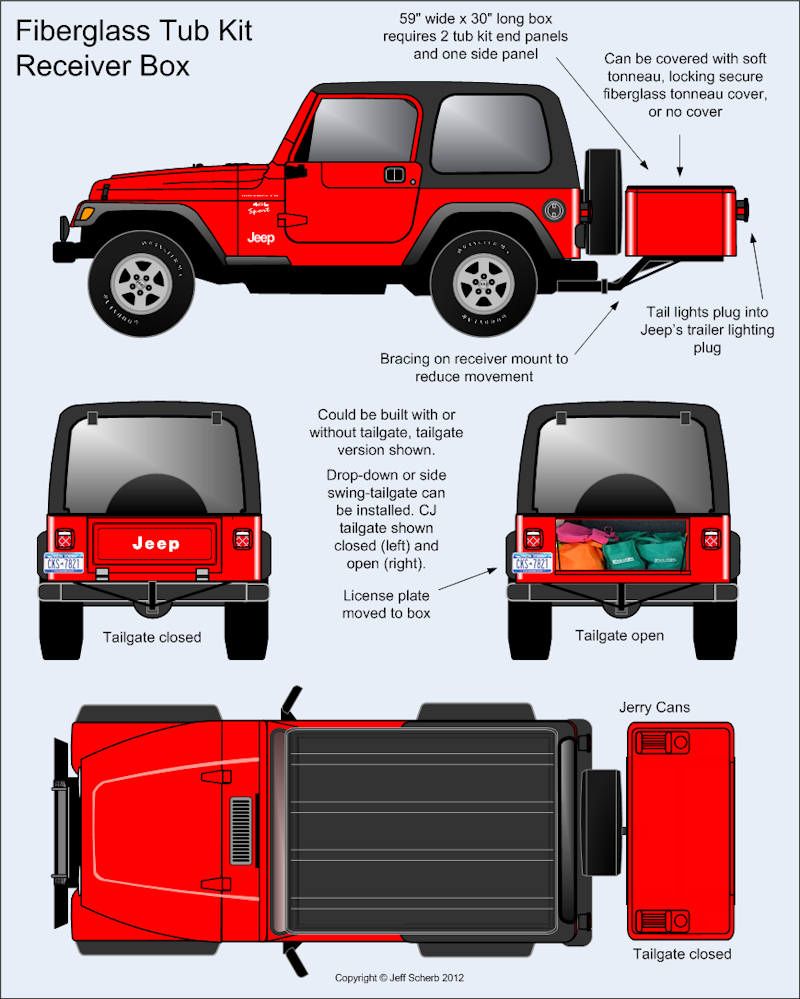

I've been playing with receiver-mounted cargo box ideas for several years - I drew the concept below back in 2012 when I was doing what became the Dinoot kit:
And this January when I molded some extension panels to make the black Dinoot tub in my workshop the same length as my yellow trailer, I mocked this up:
Your bike box idea would be a larger version of these concepts but with barn doors, seems very reasonable to build using TrailTop parts.
