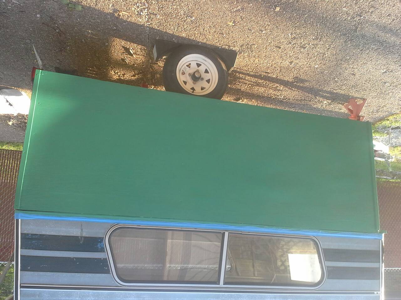

Just finished the whole thread. Awesome work :-)
My vote would be a custom replacement for the old truck cap on my camper.
