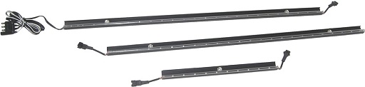

Each day, after work, I pass by the Autozone where I bought all of my 12vdc LED lights for my trailer. Sure enough, they had a Bully "Fire Strip",

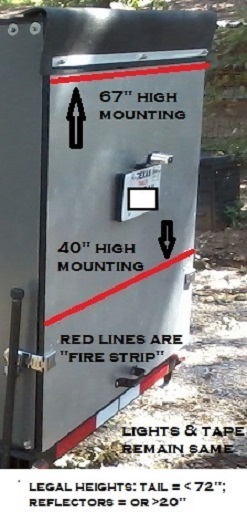

with the functions I wanted. Bought it. Now to figure out where to mount it. In addition to the 3M tape on it, I'll screw it on as well, so it'll stay where mounted. High mounted, or low? I like my conspicuity tape as-is, so I'm considering two spots on the hatch:
proposed mounting locations of fire strip.jpg (56.1 KiB) Viewed 1212 times
Either spot will work; I'll tie in the 4-way into the Spectro junction box under the trailer. Running lights, brake lights, sequential signal lights...!

Decided on a high-mount, then I taped and screwed (using PL adhesive to waterproof the screw holes) the light strip to the hatch. The control box is inside the galley, and the 4-way plug is there too; I used a matching 4-way to mate with it (so I could use an existing hole in the galley floor to connect it under the trailer to my Spectro wiring center), then I ran the wiring inside the hatch seals for a "hidden look". Programming the sequential turn signals took 20 seconds, and done.
