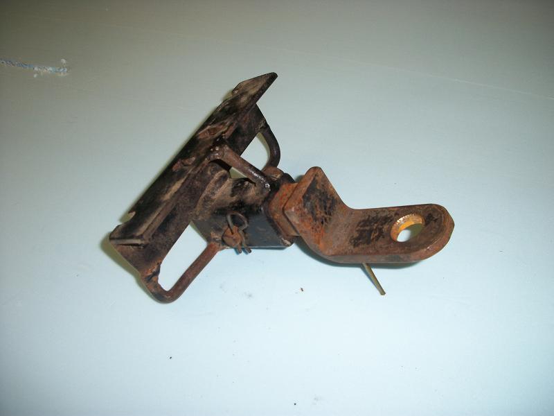

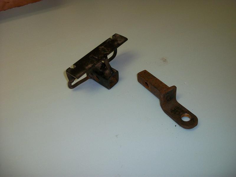

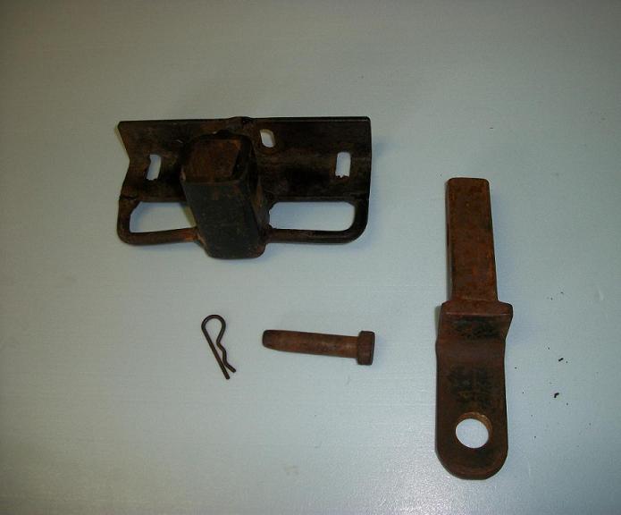

Just to breathe more life into this neat old thread I found this today......
A little tiny home made "catagory zero" :lol: reciever and drawbar.
1 1/4 x 1/8 angle is only about 5" long the safety chain loops appeare to be 1/4 " round rod and the reciever tube might be 1 1/2" square tube.
I wish I had put something into the picture for scale. It's tiny but well made and would hold several hundred pounds !

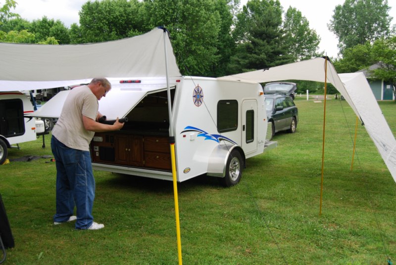

Postby Shadow Catcher » Thu Jul 07, 2011 5:38 pm
After reading the post I would like to offer an alternative that we are using. We have three tarps that attach with Kedar rail to three sides of the tear. The Kedar rail is UV stabilized plastic and attached with 3M VHB tape. The goal was not to have a not so easy up 8)
The only needed supports are tent poles and stakes. there is a great deal of flexibility in how it is erected.
The system worked very well at Boogie in the Hills with its usual thunderstorms.
