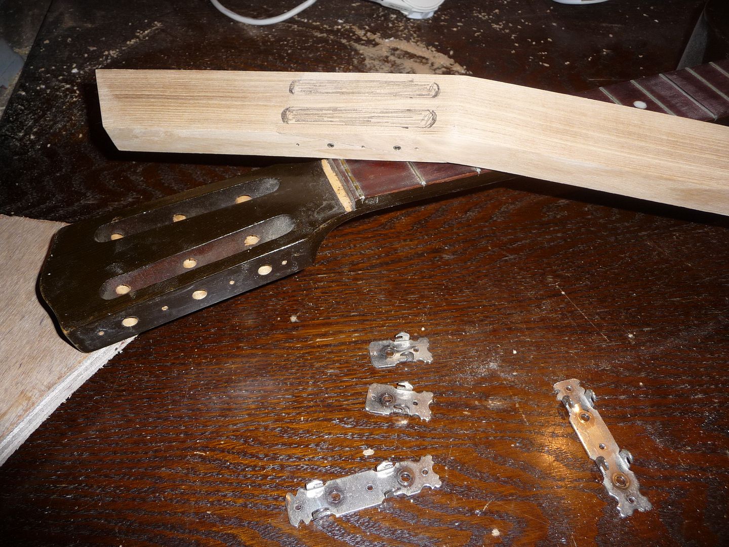

On advice from various sources and a couple of serial builders I decided not to glue the neck to the lid, but rather to have it pass below, and allow the lid to be more resonant, allowing it to amplify the vibration of the strings a bit more.
So I sanded it a bit lower.

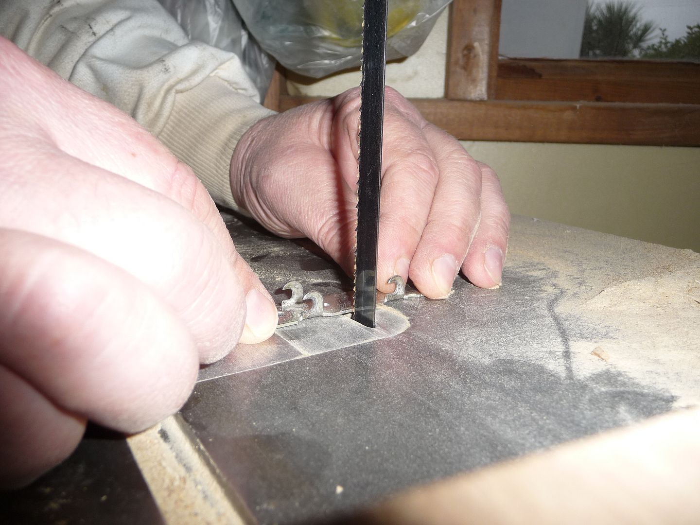

Next up I started to modify the tuning mechanism to a 4 string setup by cutting a single section off each side.
After which I filed them to make them look a bit more like the original with extra detail.
The single machine heads , well only one is complete, will be used for the Diddley Bow.
I then measured and marked the head for the recesses that needed cutting.
Drilled the basic holes and followed up with a chissel and files.
Rough finishing, and getting the angled exit right.

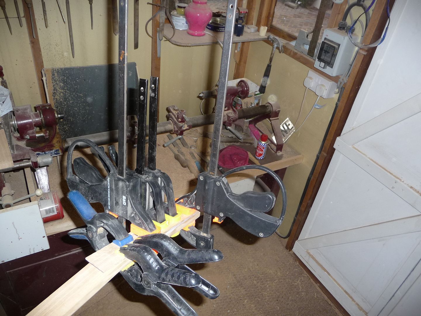

When I started to fit the second set of tuning screws it became apparent that my holes were out ever so slightly, but also my timber was cut a tad too thin when I trimmed it down, fortunately I kept the fillet, so now I needed to sand it all back and re-attach it to the head to get the desired thickness.
This of course means the holes have to be copied, lamination done and the whole thing set aside to dry for 12-24 hrs. OOOOPPPSS !!
Sliver of wood trimmed, holes copied and rough cut.
Glued and clamped. Now to be patient and wait for tomorrow, ohh, and I cannot work then either as I promissed to take Nicola out somewhere of her choice.

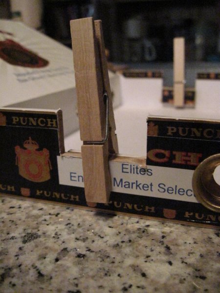

Tomorrow I plan on making up the sections to reinforce the sides of the Cigar Box, after which the neck can be fitted, and then I need to do the electrics.... not looking forward much to that.
