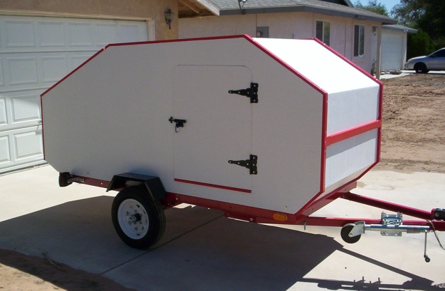

Mike , my 2 cents... Here’s my “take” on the Weekender... the WeekHopper.. :o 89596
More aerodynamic, built in overhang to keep the water away ... less Drag on the highway ... “theoretically “ :thinking:
Re: I think it's time to revisit the weekender.
Postby KCStudly » Sat Mar 24, 2012 11:27 am
Ooh, ooh, ooh, taper those aero skirts in a bit more so that they function a little better (flush with the top and sides and they are just extending the length w/o providing any interior space) and you'd really have a nice profile concept...
...but not exactly in keeping with the simple entry level Weekender concept. I like the profile a bunch, tho.
