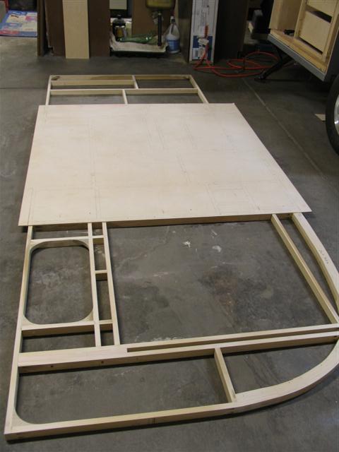

In retrospect, the diagonals don't do much for the final wall but they helped * a lot * to keep everything square during framing. I put them in after I framed the perimeter of the wall and noticed how floppy is was. I didn't want anything to move before I finished the framing and skinning. It probably would have been a lot easier to just tack a diagonal across the the frame but I didn't think of it till later and it was nice to have everything flat while skinning.

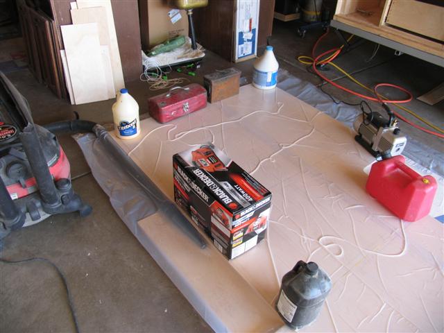

I got the vacuum pump off eBay specifically to try the vacuum bagging. It works, but just barely, I'm not very happy with it. It leaks oil and despite the continuous rating I can only run it for around 30 minutes before it starts smoking. :x Luckily, that's the clamp time for Titebond II glue. I'm looking at other options because I don't want to risk burning up my shop vac either.

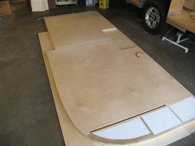

I got to work this weekend skinning the first side wall. First I skinned the outside with 1/4" plywood. Nothing fancy, just titebond and staples.

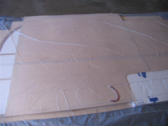

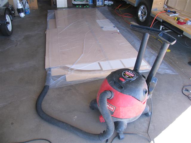

After the exterior was skinned and insulation added, Jean and I glued and vacuum clamped the 1/8" plywood interior skin. No nails or staples, just a few 27 gauge pins to keep the skin from sliding around in the bag. My vacuum pump couldn't keep up with all the leaks in the larger bag so I used the shop vac. We used packing tape to close up the bag and there's just too many little leaks for my 4 cfm vacuum pump. I was more than a little worried the shop vac would burn up but it held up for an hour of clamp time.
We skinned it in two passes. Here's the front skin clamped and glued:
Then we moved on to the back half. We had a little trouble getting it sealed so we added some weight at the corners. I think we got a little careless checking the seams and there were a lot of little leaks. I got a good clamp after I checked the tape again. The string in the bag gives the air a path to the vacuum.
How did it work? It worked GREAT!!! The 1/8" plywood was really wavy and there's no way I would have been able to staple it flat. I'm really happy with the results.

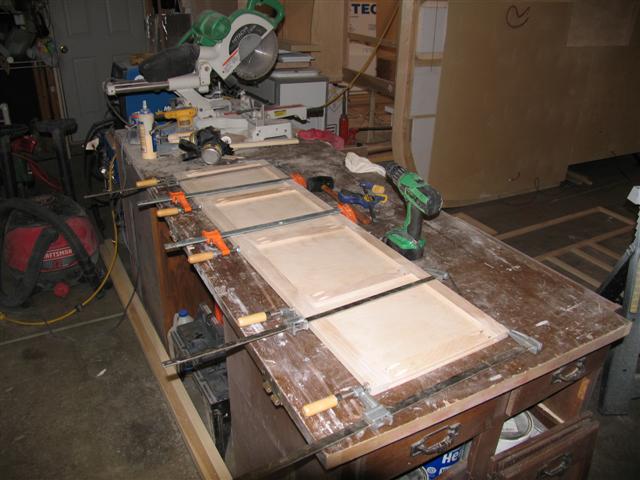

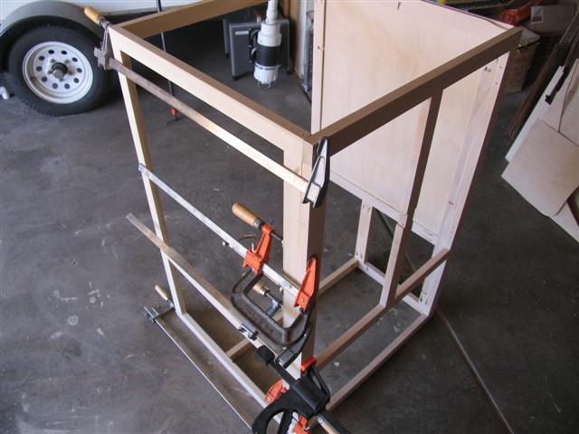

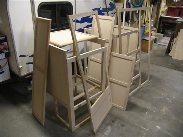

Finally got around to sanding and gluing my cabinets together. I've had them roughed together for awhile but I hate sanding (makes my back hurt). So here's a few pics.
Gluing the sides of a cabinet together:
Here's one pf the panels for the bed.
Refrigerator cabinet and sink cabinet.
Here's everything - Two cabinets, a bed frame, closet and drawer frame. Not a very big pile for how much work it is. :roll: But it is pretty light...
Next its gluing and staining the cabinet doors.

The bag is made from 10mm poly from the paint department at HD. I tried rolling and clamping it but it leaked too much that way. We ended up just taping it shut with packing tape. First, I squirted titebond glue on the framing and Jean spread it out with a foam paintbrush. We laid the plywood down and shot a few pins to keep it in place while we bagged it. Jean held the edges of the bag together and I taped it down. The hard part (and it wasn't really that hard) is to get the tape on without bunching up the plastic and causing leaks. Then we turned on the vacuum and made sure the tape was stuck down everywhere ( you can hear if there are any leaks). 30 minutes later and its done! I was worried about burning up the vacuum because of a lack of air flow but my vacuum leaks enough internally that it wasn't a problem.
