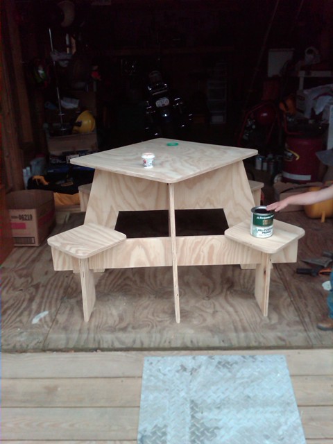

My solution was to route a 7/8" x 7/16" deep groove where the table and seats would meet the supports. Not only did this solve my problem with the dowels and holes it made the table lighter as well.

BRILLIANT !!!!I hadn't thought of that. Let me know how the 5/16" of ply remaining holds up after some use. I would have been more conservative and only went 3/8" deep. Good ply would make a big difference here also. I think that I'll make your groove idea an option on the plans if you don't mind.

Miriam C. wrote:If the groove proves a weakening issue then perhaps some 1/2" x 1/2" or larger rails on either side. That is what I thought you were doing...
rebapuck wrote:I'm not seeing something. It looks to me like the seats, crossbar and seat supports are all screwed together. How does it come apart? Is it unscrewed to dismantle?
