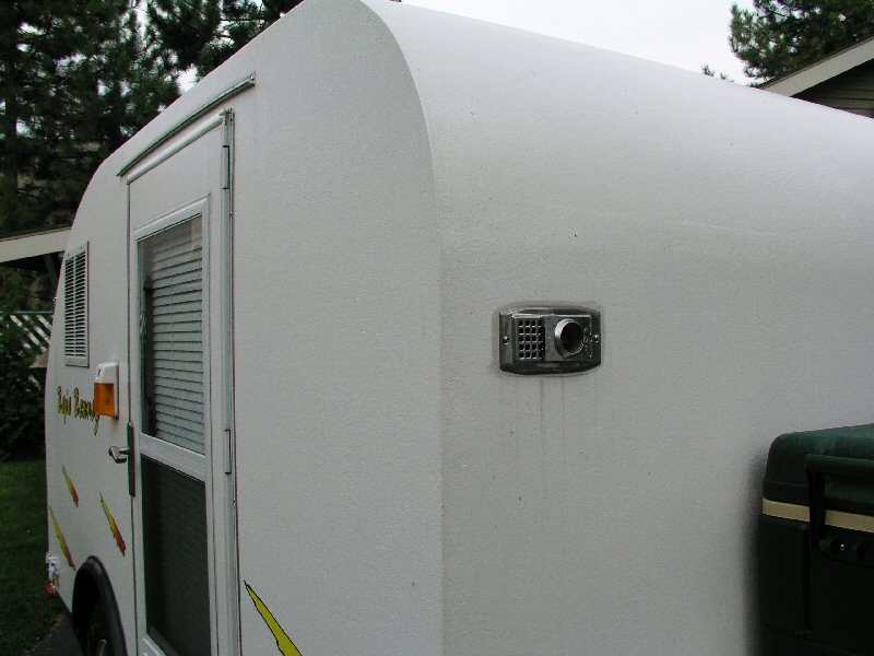

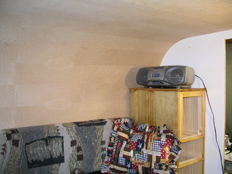

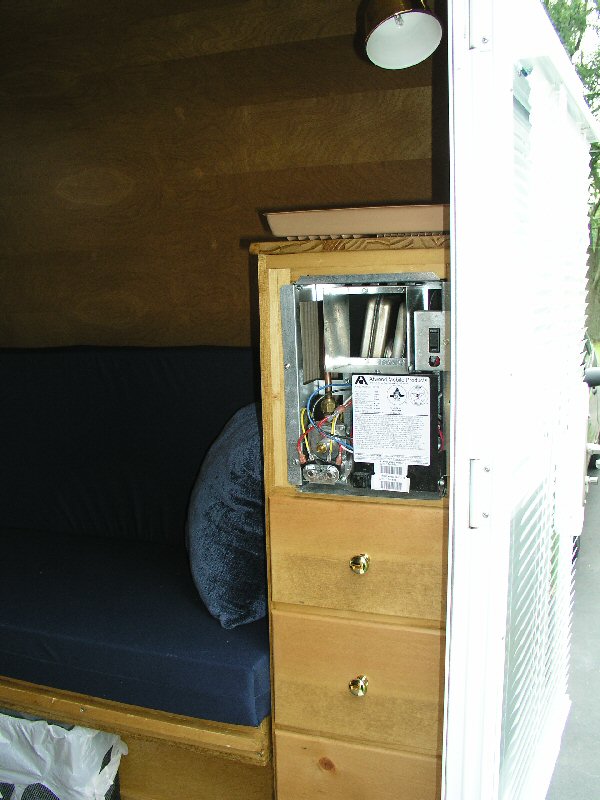

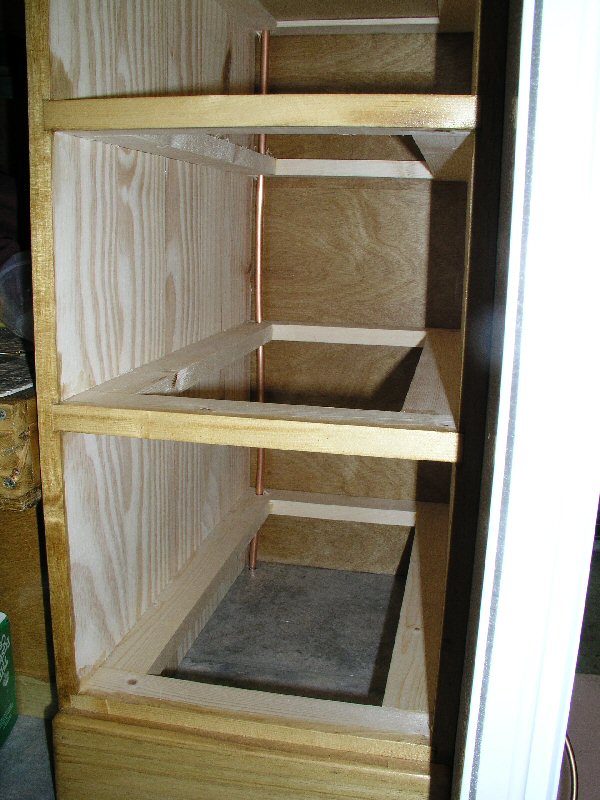

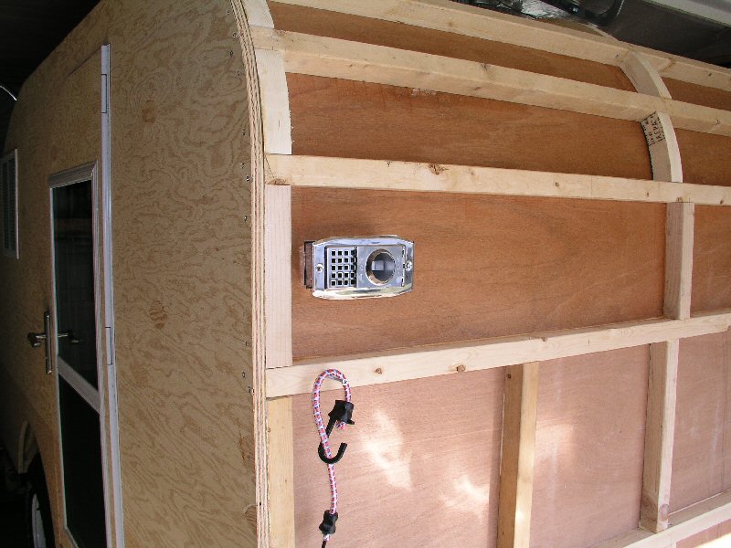

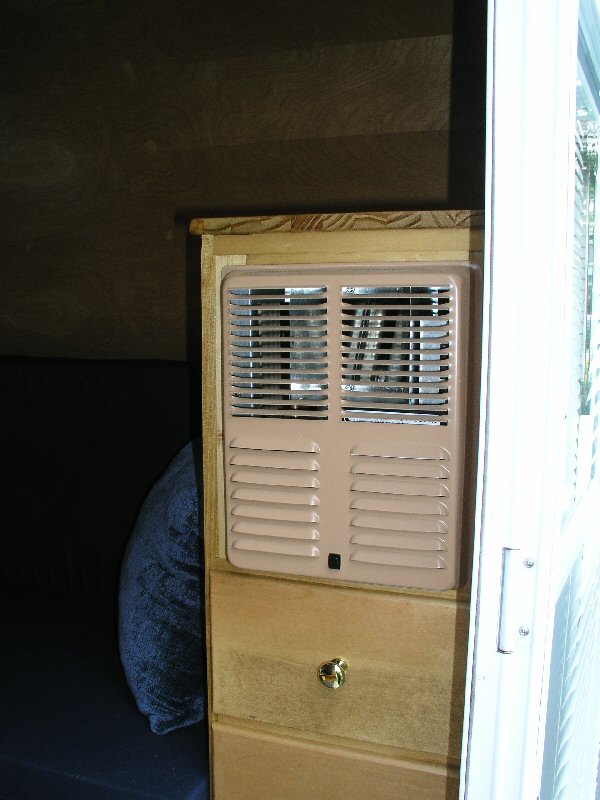

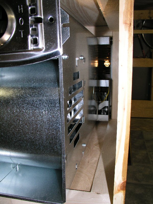

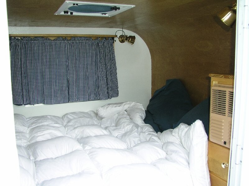

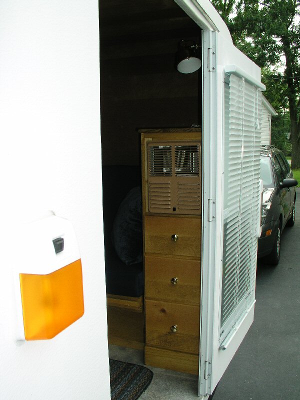

Here's some more pictures for you. This is the forced air furnace that I put into my Baja Benroy...

That is some real fine work. Would it be alright to have the furnace on the floor. I was going to put shelves above it for can goods and other things.
I do like the idea of a removable cabinet just incase of a break down.

Putting it on the floor is fine, as long as there are no combustible materials in front of it. BTW, that cabinet was no longer removable as soon as I run the copper tubing...
One thing to think about is how the air flows when the heater is running. I've always put it at the bed level, to get the maximum breeze through the trailer. Although in our small trailers we don't always have a choice where to put it.

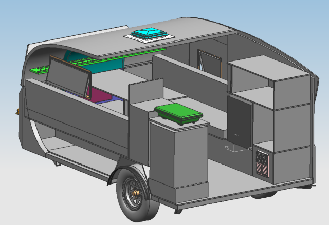

One of the designs I worked on had it on the floor.
Although my current design might have it here:

Although it sounds good, that means you have to vent it thru the front, right? I'm not sure I'd vent something thru the front again. Too easy for the water to get in when you are towing.
