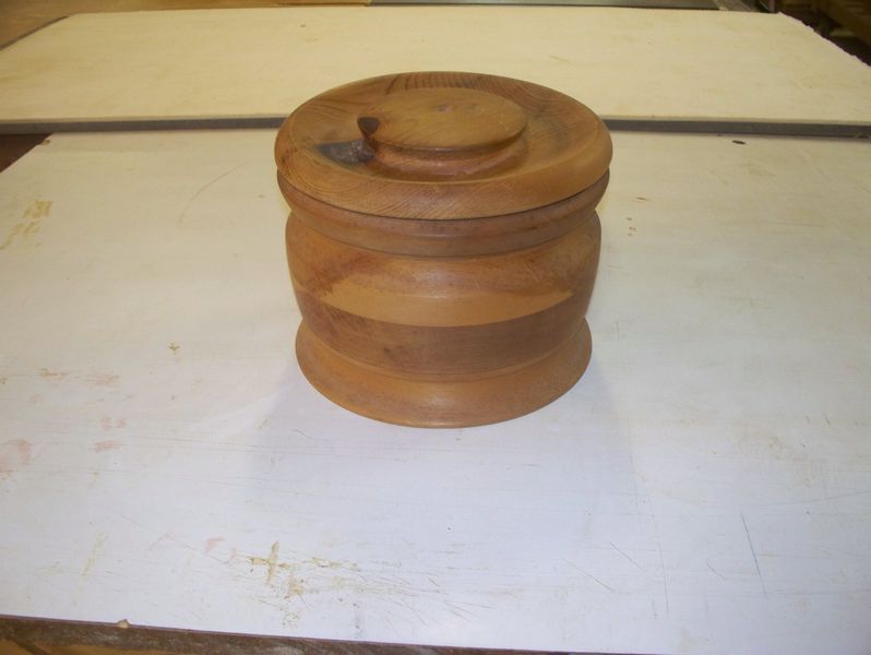

All this wood turning brings back memories of when I got into woodworking in the 70's I worked at a waterbed factory and I started turning bowls with a machine I made from a simple shaft with 2 pillow block bearings ,a step pulley on one end and a face plate on the other....I would use pine 2x10 alternately glued up and used a manila folder glued up in between the lid piece...I got to where I didn't want to hogg out all that wood inside the bowl so I made a jig to cut the centers out of 2x10 using the overhead pinrouter we had.....Those were the days making tables out of headboard parts etc....

I found one of those old bowls I did..
