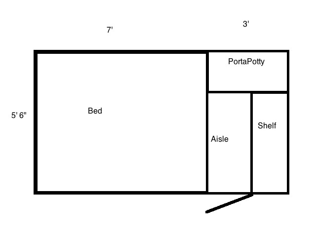

I'm thinking about modeling up a standie in CAD. I might turn it into blueprints, or I might turn it into plans, like the Generic Benroy plans.
But I need your thoughts.
At first blush, I'm thinking about the Puffin. With the bed and the porta potty, it could fit the bill for a lot of people who don't want to trek to the outhouse at night.
I'm thinking it could be built on a H.F. trailer, out over the wheels.
So here's the question. What floor plan would you guys like to see?
If memory serves me correctly the Puffin had a bed that was only 48" wide and 72" long. I'd like to see a larger mattress than that.
The Puffin had a bathroom/shower that was 30x36". That seems okay.
So point me in the right direction, something that would appeal to the most people here. ;)

It sure would be nice to package something on the 4x8 HF trailer... I'm not looking for much, just a bed and a portapotty. :?
Maybe something like this for a floorplan?
Postby madjack » Thu Jul 03, 2008 9:04 pm
OK, keeping the bed lengthwise will allow the usage of the 4x8 HF trailer with 6"s over the tires(not my favored way of doing it...BUT...) and still have a queen bed and stretched to fit the rest of the requirements.......
