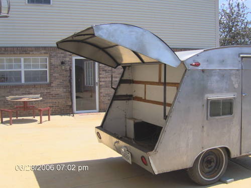

Postby del » Sun Feb 01, 2009 7:38 pm
I take it there is shelves that go in there. Interesting trailer there.

Postby greg755 » Sun Feb 01, 2009 7:43 pm
There is nothing in it right now. All the shelves were taken out.

Postby mikeschn » Sun Feb 01, 2009 7:45 pm
What's the inside look like?
Postby greg755 » Sun Feb 01, 2009 7:51 pm
The inside had 2 beds with storage underneith, and a table that slid out the back and two bunks. That has all been removed as well as the galley shelves, ice box, stove and water tank.
