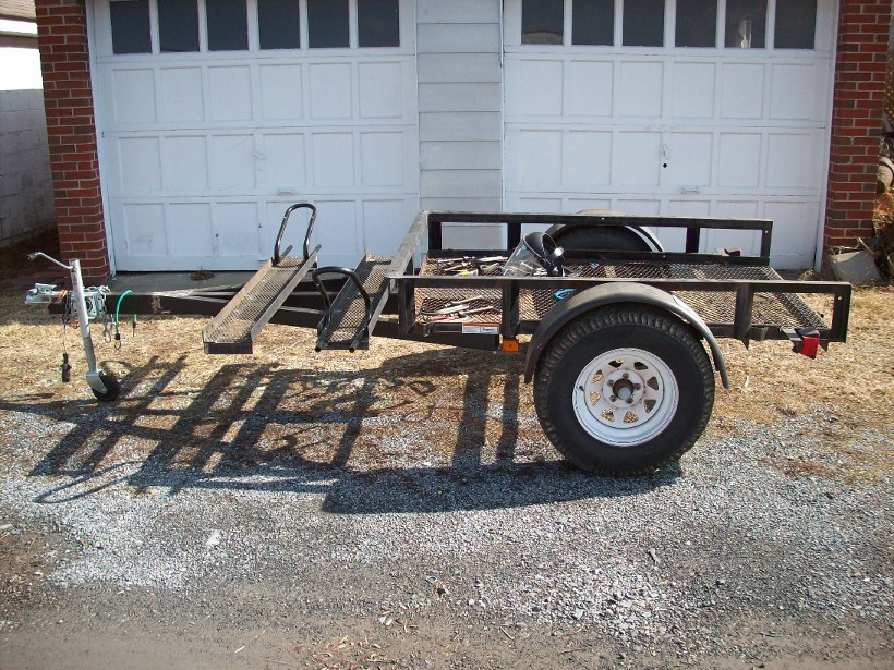

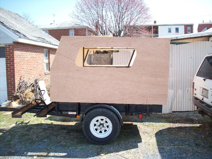

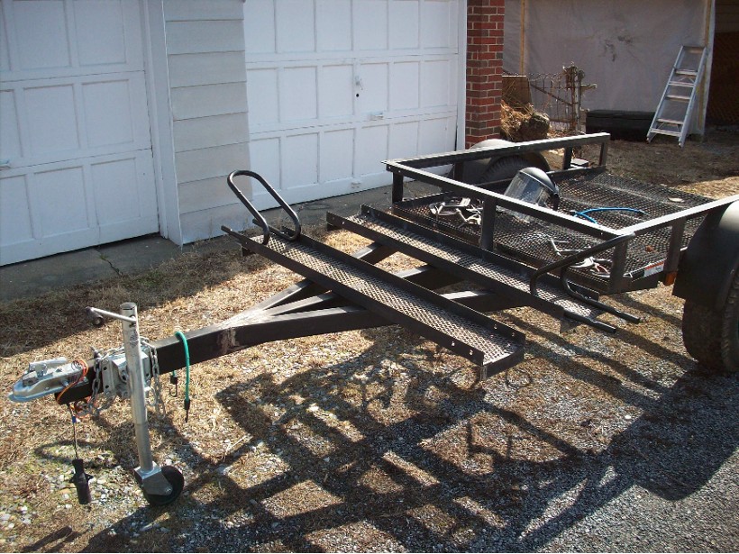

I finished the steel work on the trailer, all I have left is to prime and paint. Since I've decided to make the beast modular (I'd like to remove the camper body so I can still use the trailer for it's original purpose) I'm going to prime and paint once the weather gets a little more predictable.
Here it is so far:

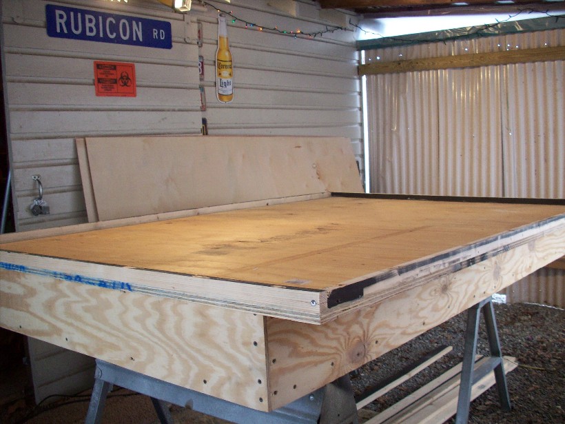

I built the "basement" and coated it in Black Jacks roof sealant.
Sorry I don't have any pics with the roof coating.

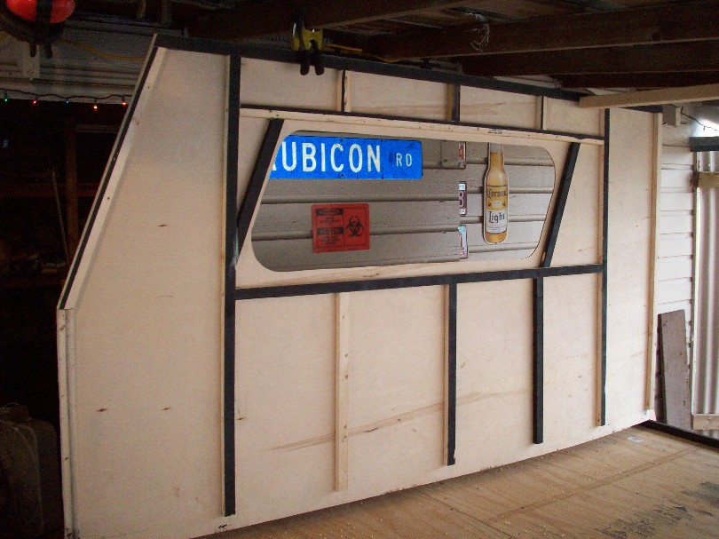

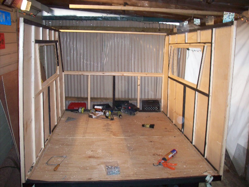

Next I move on to the side walls, it took a lot longer than I planned.
Got them mounted and started framing the front.

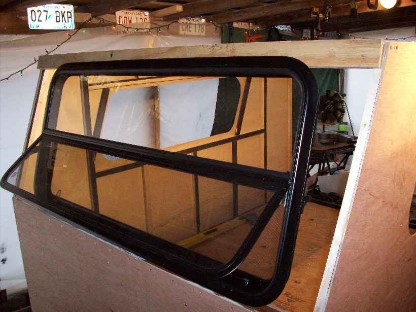

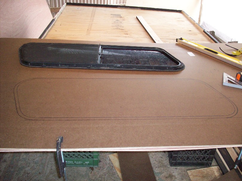

A goody came in the mail today!!! The front window from e-bay!!!
The test fit. It works!

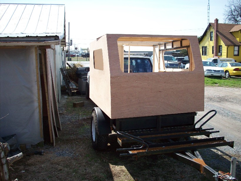

Well, I finished the side walls, the front wall and the roof spars. I roped a friend of mine into helping me test fit the beast to the trailer
SUCCESS!!!!! :D
The thing is a little taller than I was expecting but oh well!! It sits at about 7 feet. The top of the jeep is 6'3" so not to bad!!
More to come!!!

Just a warning. Most commercial campers with front windows have a close down awning over them. I have a window on the front of mine and had no problems when I was towing it with a truck with a campershell because the air stream off the tow vehicle cleared the window but when I went to a truck with a hard bed cover it changed the air stream and now the window leaks when towing in the rain. Not nice crawling into a soaking wet bed after a long pull through a down pour.
Hopefully you don't have the same problem.

Thanks for the idea Ray! My plan is to install an awning over it with a piano hinge that will flip up. I plan on sealing the hinge with a rubber strip so I don't end up with wet pillows!
I'm so happy the build is finally off the ground so to speak. I'm finishing the roof this afternoon then it's getting taken off the frame and brought back into the carport (too tall). Next is the insulation and window install.

I plan on using 1/2"x1 3/4" bolts straight through the 3/4" plywood floor into the rails of the trailer. To reinforce the connection, I'm going to use uni-strut the length of the camper floor. That way there is a solid steel-wood-steel sandwich.

...nice...I like the basement, so what are ya going to carry on the front...I ask because, I'm nosy and was wondering about balance issues.........
madjack 8)
Posts: 15128
Postby jollymon1375 » Tue Mar 24, 2009 12:03 pm
2 50cc scooters, they come to a total weight of about 375lbs. When the scooters are on the tongue and no camper body on the trailer I can lift the tongue by myself. It hurts a little though. But since the camper is pretty much center over the wheels there shouldn't be a big change in tongue weight. I'm going to be adding a bumper and a spare tire carrier to the rear so I'm hoping that'll help balance things out.
