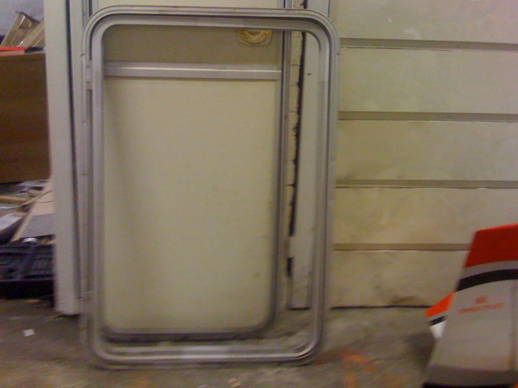

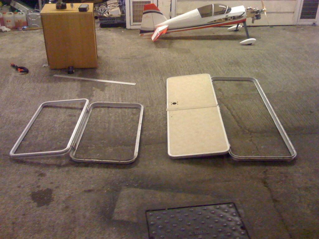

so to start i picked up 2 doors at our local caravan breakers,
today i made a start on the first door

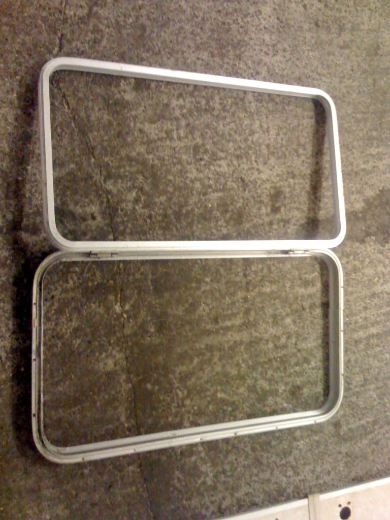

here you can see i have shortend the first door

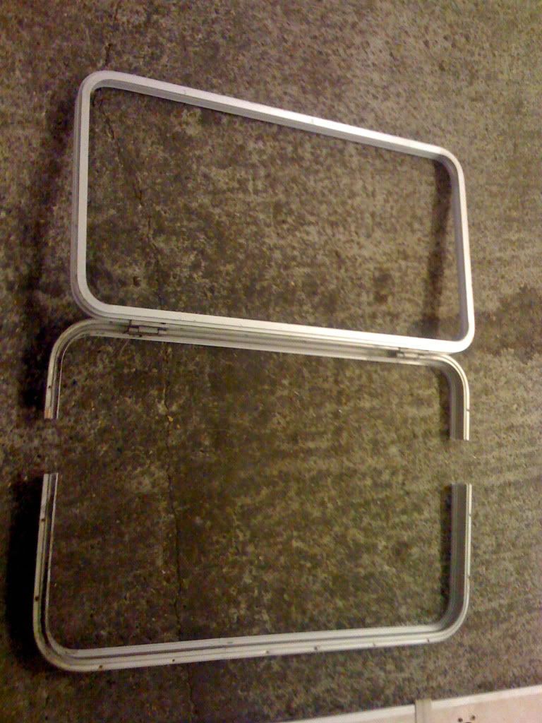

But the other half complained that it was not wide enough.... :roll:
so i had to widen it, i did so by 5 inches.

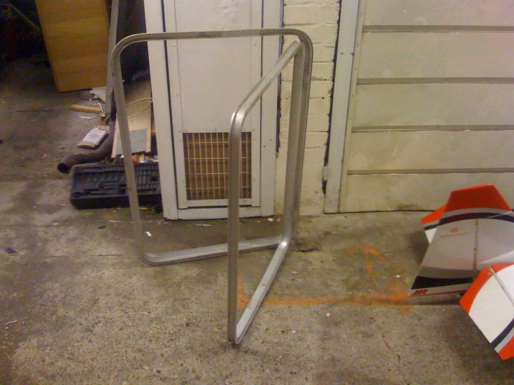

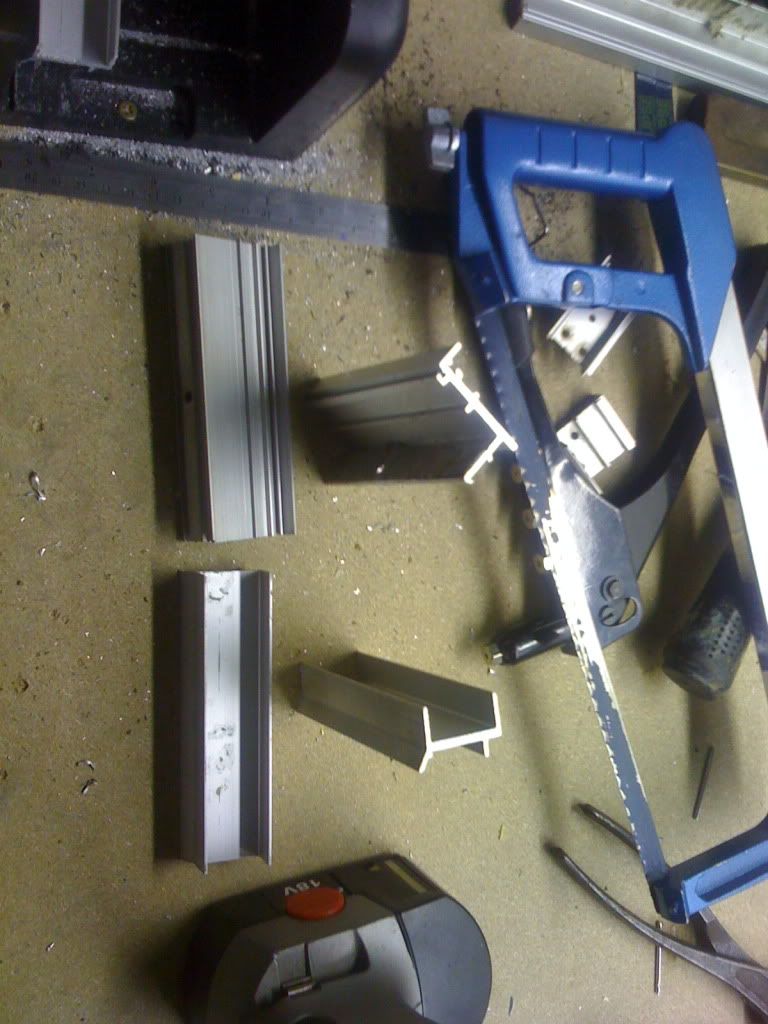

frame cut
extension pieces.
new wider door and frame! :)

Thirdly, I almost had to ask if that were a full-sized aerobatic aircraft in your hangar... but I see now that it's an R/C bird. Still... great stuff.

yes sadly its not a full size real one :(
it is indeed a R/C one 28ish %, tis my baby (well till i sell it to buy a bigger one :twisted: )

A great start mate. How are you joining the frame back up?

the frames are held together with rivets and with plates on the insides cut from the left over pieces of frame, but i do need to re think it as there is some wobble in the joins.. i may try and tack weld them to keep them nice and stiff, i will try striping them down and build them into the cut out in the sides if i dont weld them, useing lots of sikaflex! hopfully sitting in a cut out and having a board inside the door will stiffen it up...
