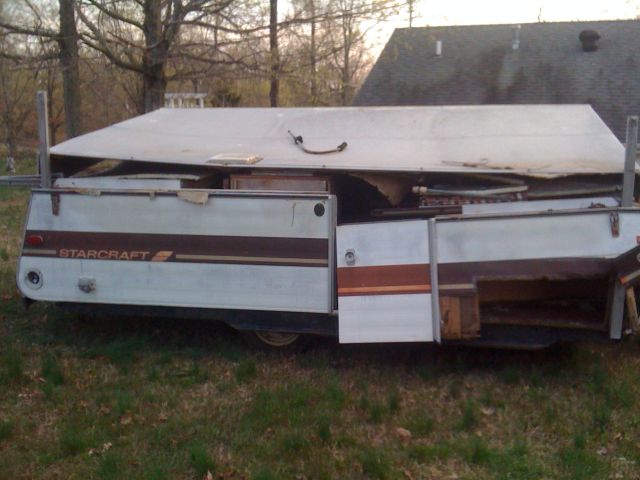

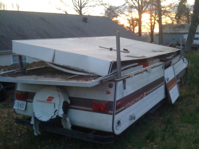

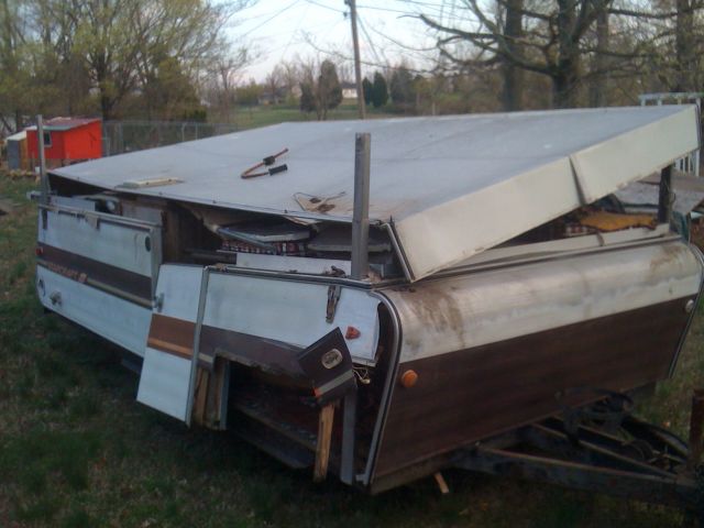

ok here's what I have to start with. a early 70's model pop-up it's a 6x12 box. it's gonna be bigger than what I was planning. can a camry handle it if I stay really lite? manual says towing capacity is 2000#. I will also be adding a trans cooler,will this be ok?

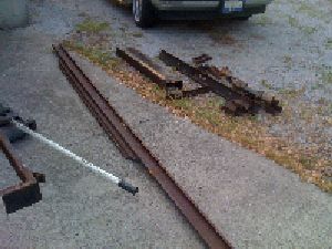

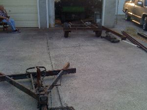

here is some progress. welded some back together this evening, hope to get more done tomorrow. also picked up my plywood, insolation, and will be ordering the epoxy soon. narrowed by 1' and shortened from 12' to 10'.
thanks, Brian
