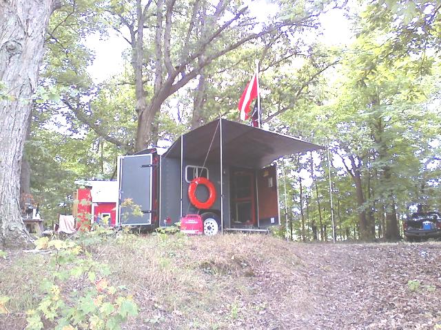

Postby bobhenry » Wed Jun 08, 2011 7:31 am
The images I have seen of your unit shows an awning rail. They may be an option but there are clearly on the ones in the pictures of the units I have seen.
Here is a couple pictures of my campin' buddy scuba's awning rail on his cargo.
That is nothing more than an inexpensive tarp available everywhere. He folds one time over 3 - 4 pieces of 1/4 fiberglass survey stakes
( available at any farm store) and slides in into the rail a length at a time. A couple support poles out board staked off keeps it tight. It would be easy to form a length of emt electrical conduit to the same radius as the roof and drill and slide it onto pins off of the outer support rods Giving you a natural rain shedding form.
I have spent a few rainy evenings under his "side porch" and it is a great addition.
