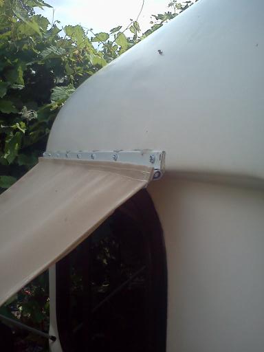

I used old TV cable on mine. :thumbsup: You can almost see it here.
