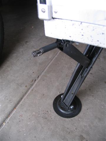

Tired of the time commitment and drudgery of lowering/raising your BAL jacks? Do you need more time for friends and family? I have the solution for you! We have BAL stabilizer jacks on all four corners of our trailer (which IMHO are the best jack available for a small trailer) :

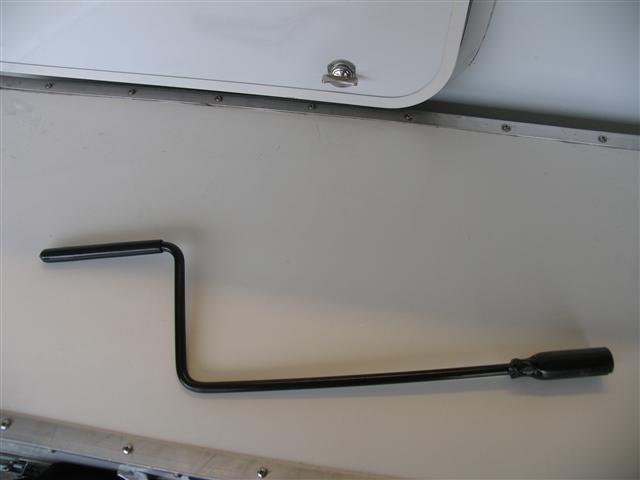

Each pair comes with a jack handle:

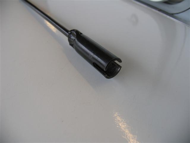

The socket has a slot in it that goes over the jack screw:

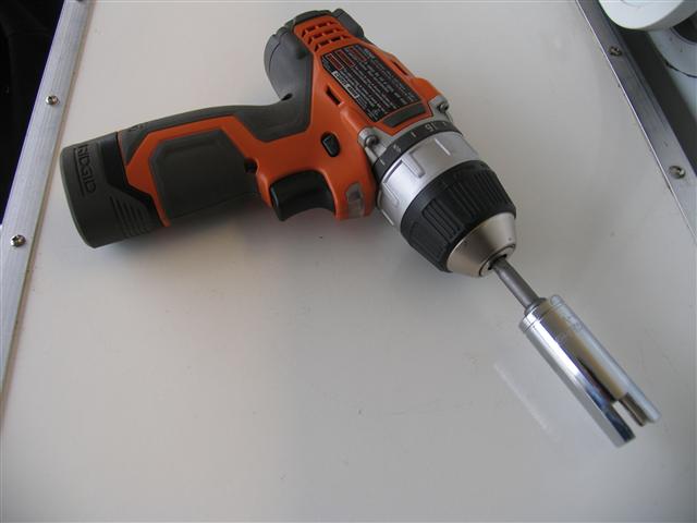

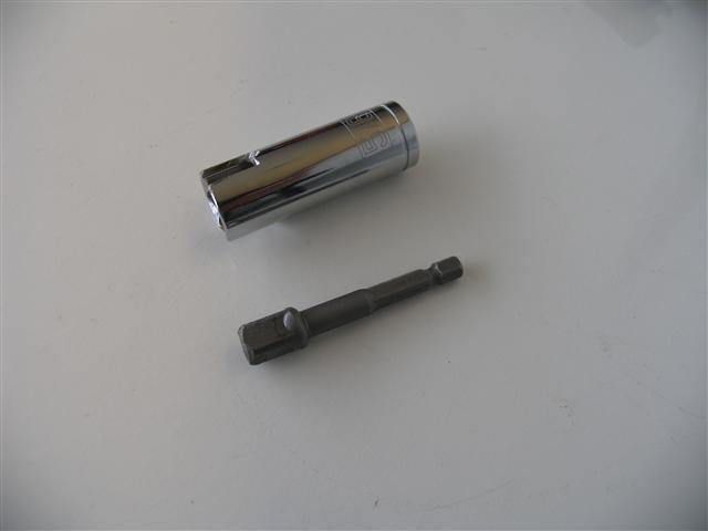

I ended up with 2 jack handles so I was going to cut the socket end off one and stick it in my cordless drill. No more drudgery! BUT, then I looked at the price for replacement handles as I tend to loose things and they're not cheap! So I made one for $3 with a 5/8 deep socket and drill adapter from HF Tools. I just cut a slot in the socket with a grinder. Try and get the slot centered in the socket or its a bit wobbly but other than that its a cinch:
Here is is in the drill:
How does it work? Well its pretty fast and drudgery free. I don't think I'll take it camping but it's nice for use when we get home:
