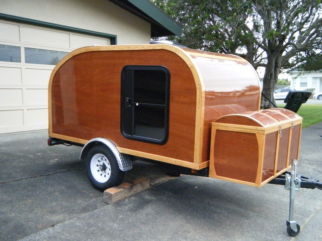

Postby jabrobbins » Sun Dec 11, 2011 8:46 pm
I built a 5 wide too. The wheel wells will be about 4-5 inches high and 6 inches wide to clear the tires with axel under springs. If you put the axel over the springs your wheel wells will be higher. Zack's method is cool because he will preserve bed space and headroom. I actually built under bed storage so I sacrificed 5" of my 4 foot interior, but I can live with a thin mattress.

jabrobbins wrote:I built a 5 wide too.
Your teardrop is beautiful! Very nice work! :thumbsup:
