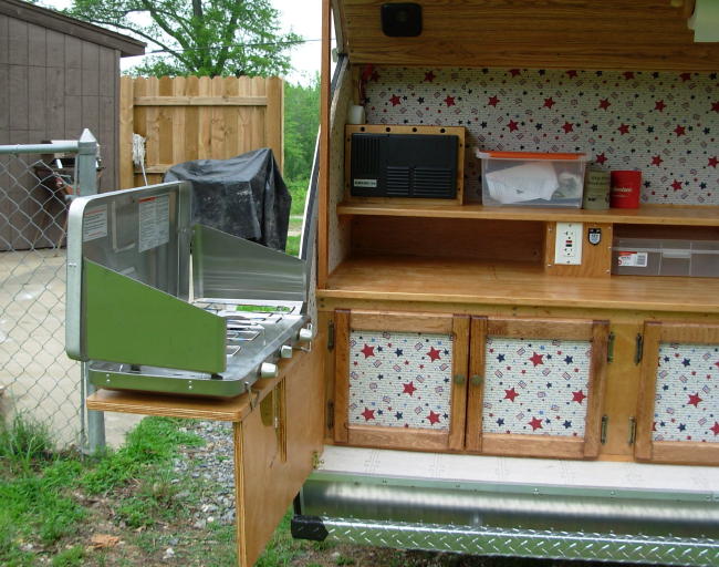

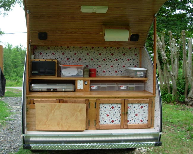

I have mounted an additional 'rail' on the opposite side of the TD so this table can be used there also; if I ever find another piece of 'scrap' 3/4" birch ply I'll make an additional table for that side...
This table 'base' is hinged to the sidewall of the galley, & table folds up for storage/travel

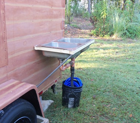

hrm I have a sink
and a table.... that mounts over my tongue/deck
I have and idea for one that mounts on my rear barn style door that will hold a clothes rack based on the same thing as my sink. chuckles.

Nobody:
In your second picture, how does that supporting rod anchor to the trailer?

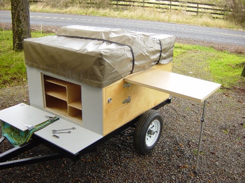

There are still some of the Thule RV ones floating around.
I normally make them out of 1/2" baltic birch with a 1x1 strip around the edges attached with a mating track.

I just have a hole drilled in the siding (sealed w/epoxy) & a matching hole in the support, place a 5/16 bolt thru the holes, remove & store in galley box when not in use. The support rod is hinged to the bottom of the table.
