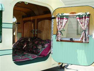

simple stuff like this
or more ornate like
173882......173887
